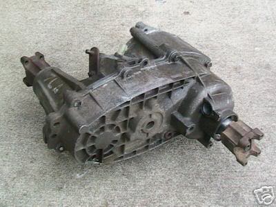

the front fixed yoke m1350 is apparently pretty rare but i just snagged one after 3 weeks of searching all the jy's in the back 40 of gods country
here is a pic
i guess i'll just have to get used to the 4x4 lights flashing, or is the something we can do to stop it?
here is a pic

best i can tell, the main prob with the 1350s was the front output, i didnt know that some came with the fixed front yoke. there was also some improvement with the internal parts with the 1354, 6 gear planetary instead of 4 and some other things. but this particular tcase should work. i will find out tomorrow and take pics

just swapped in the fixed front yoke 1350m this weekend, works fine. i started a thread in this section.
