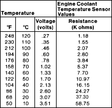

ECT sensor?
Do you have any way to read the engine coolant temperature (ECT) via the OBD II bus? Maybe the ECT sensor is defective and the PCM "thinks" the engine is cold when it is actually warm. The result would be a rich mixture. Is the exhaust black when the engine is warm started indicating a rich mixture? If you can't read the ECT via the OBD II bus then you can measure the resistance of the ECT sensor and compare it to the table below.
thanks, I'll see if I can check that
