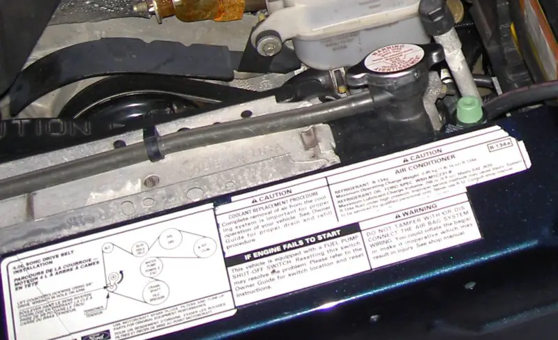

I know a '99 take 30 ounces of R134 and 9 of PAG 46. Should be written on the core support though.
Ditto, it's very close to that 30 ounce figure, and I recall the oil being 8oz, but that was my 91 Lincoln with the old R12 freon. I haven't had to service any of my three 2nd gens so far, lucky I've been there.
Here's the radiator support labels on my 99 Limited. I removed the French sections and arranged the others better. I could barely read it, but it does say 1lb 14oz, plus 9oz of the oil.
