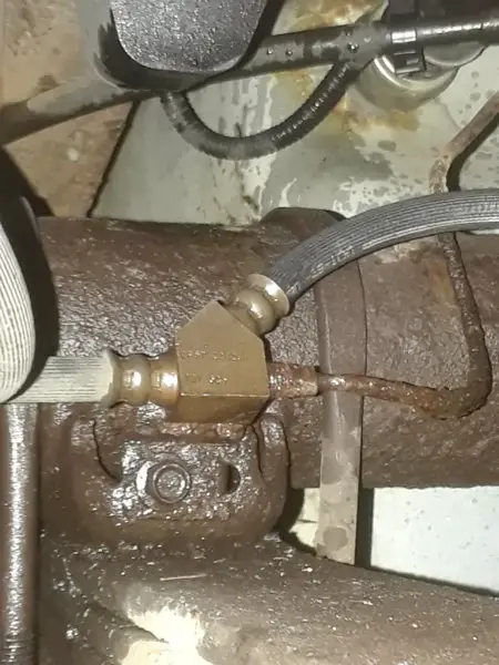

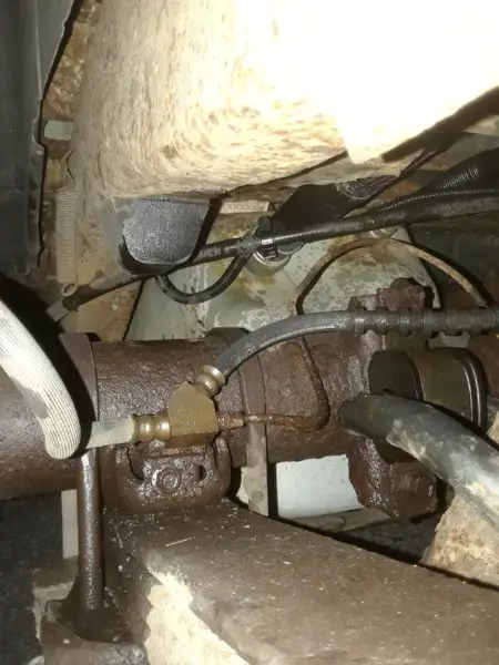

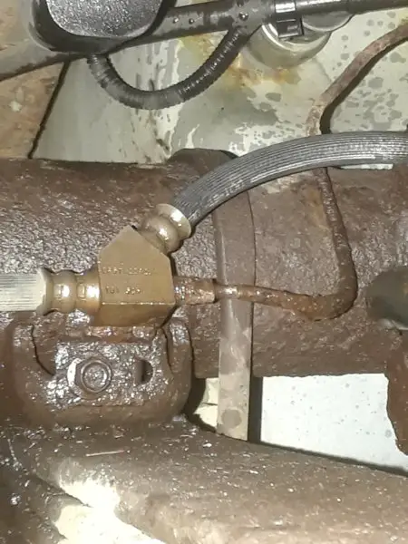

Over 20+ years of owning my Explorer, it has had no brake flushes, and no braking problems. Finally a year ago the rear axle line rusted from the outside, and leaked, and I put new lines on, and flushed it.
