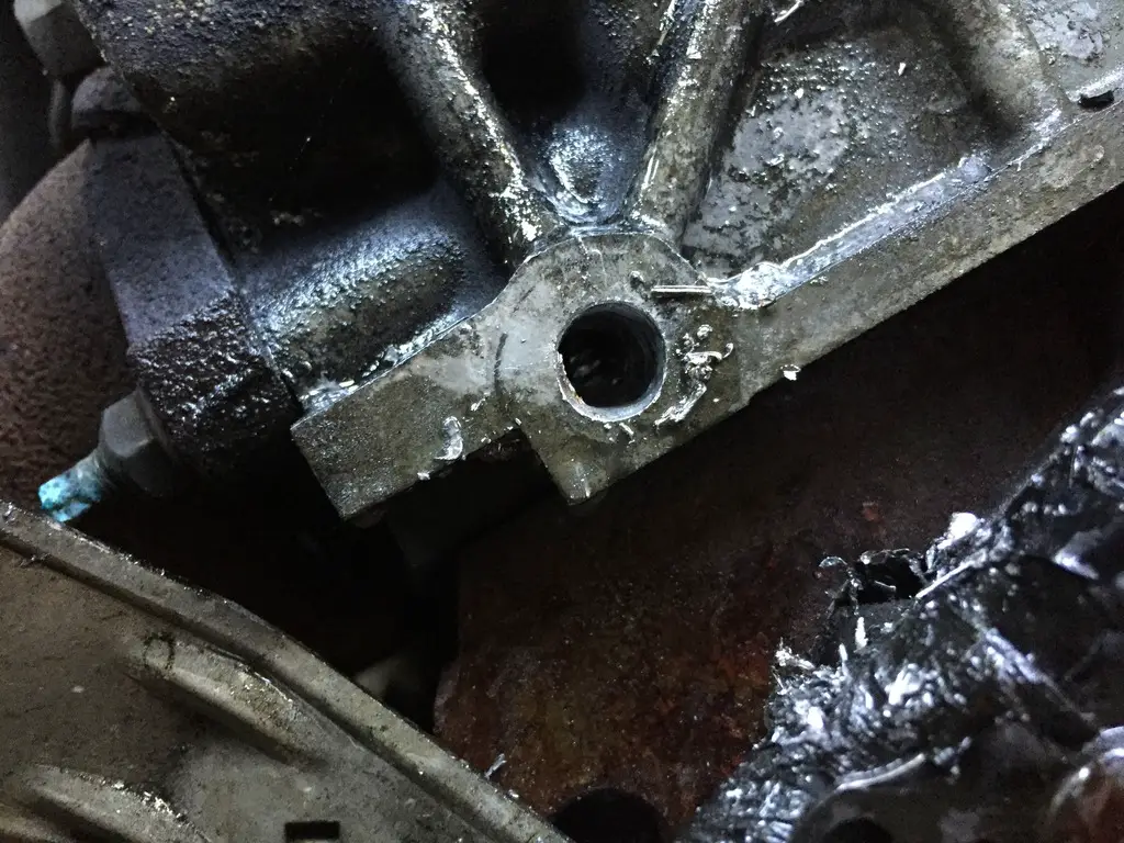

So.. Got everything off.
Radiator, fan clutch, shroud, air intake. Drilled the a pilot hole. Tried a ease out and snapped it
So with that being said. Anyone have any suggestion on how to remove these bolts
I'm not sure how they broke or what caused the to break. The bottom on broke flush with the head. The middle broke with a little sticking out.
I tried a left handed drill bit but it was the same size as the bolt and was right at the threads.
I'm debating on removing the head but don't know if it's worth the trouble.
Good news. After weeks of it sitting there. My friend finically came and helped me (he works 6 12s)
But we drilled the bolt out. He robbed some hardest recoil inserts from work(he works in a die cast machine shop) we drilled a 16mm hole for the inserts. Went good. But...
The bottom left hole we drilled too far and it ran into the head bolt. Shouldn't cause that big of a deal
But the middle hole well it was a tad off center and made a hole half way through and the hole is in the actual head not a huge hole the insert covers most of it.
So we took jb welded the insert end to create a seal and jb welded the front.
So how bad is this messed up?
Looks good but worries me on that drill on first pic which is not centered.
I take all credit for it being off centered. My fault. He did good on drilling and tapping it.
When I was using the ease out and drilled the pilot hole I got it off center can't blame anyone but myself.
I would think it would be fine. The helicoil insert covered half of the hole and we used jb weld to seal the bottom of the helicoil. Then the front of the helicoil where it meets the head. Should be fine. If not I can't blame anyone but myself
