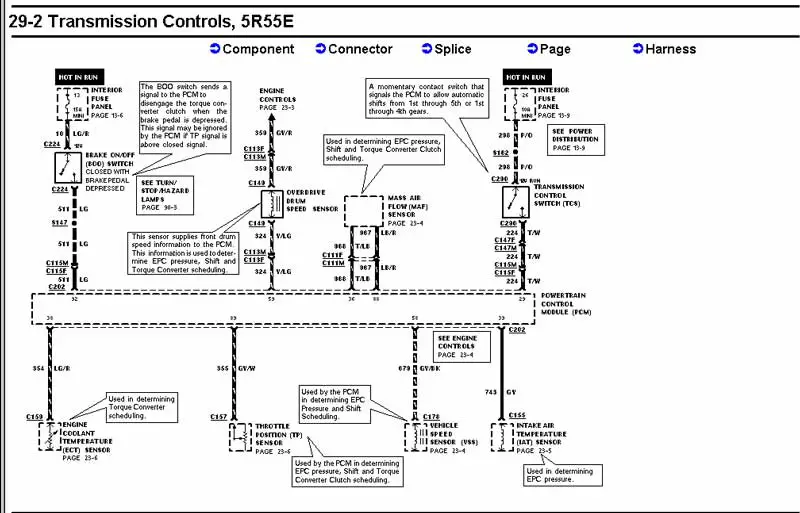

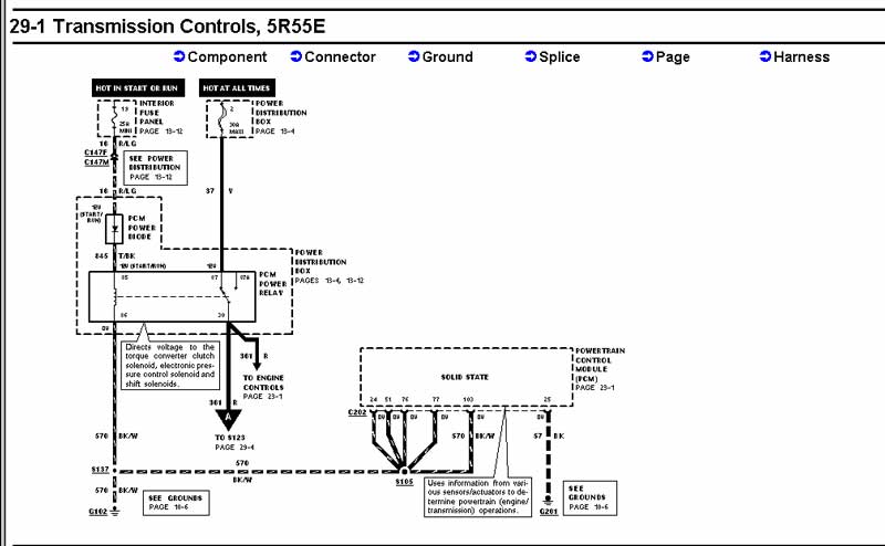

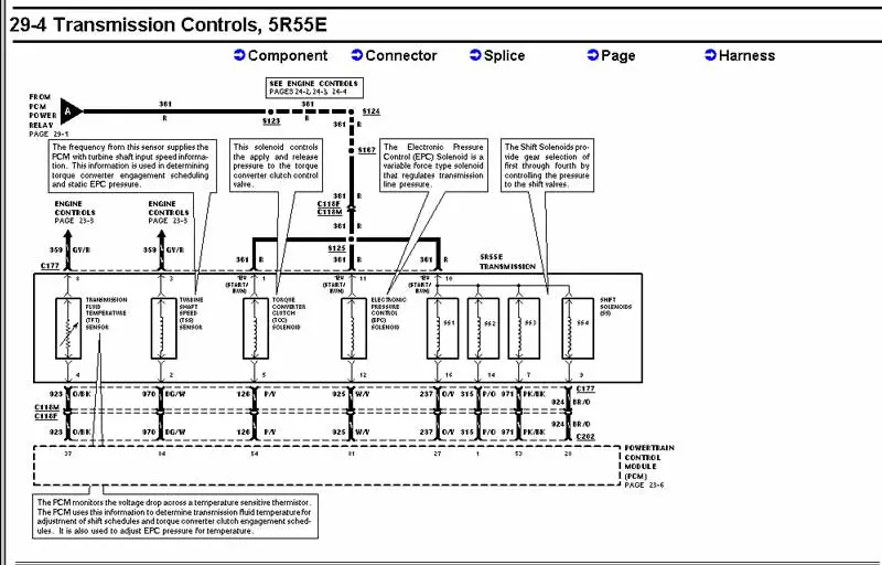

When I put a '99 tranny in my '96 I had to make a custom external tranny harness to match the internal one. Ford combined a few of the pins on the '99 interior harness so the '96 external one wasnt making the connections it needed to.
When you PMd me I thought you were 2WD for some reason. That's why I fed you that BS about tail shafts! :confused:
So just find a wiring diagram for the two trannies and make sure they're the same. If not, make the external one match the internal one. (I had to do that my conbining a few sets of wires). No prob.
I have the wiring schematic for the 97 - I can post it later when I get home from work ~ 7hrs from now.
Maybe someone can post the 98 wiring schematic also?
This is for a 97 transmission

page two

page three

thanks guys i am just going to e-mail all this to my dealership.
I have no idea what i am going to do. if the ABS Signal is not the same as the 97 VSS then i have a problem. I guess i am going to have to take the X to the junk yard.
The ABS is not the same. But it won't matter. As long as your computer is happy you can have all the VSS's you want.
All they did in the later model explorers was combine the ABS (rear) and the VSS. So as long as you have the VSS in the transfer case, which your 97 comp is looking for) it won't care whether its in the axle or not.
I say as long as your tranny harnesses match eachother you'll be good to go.
