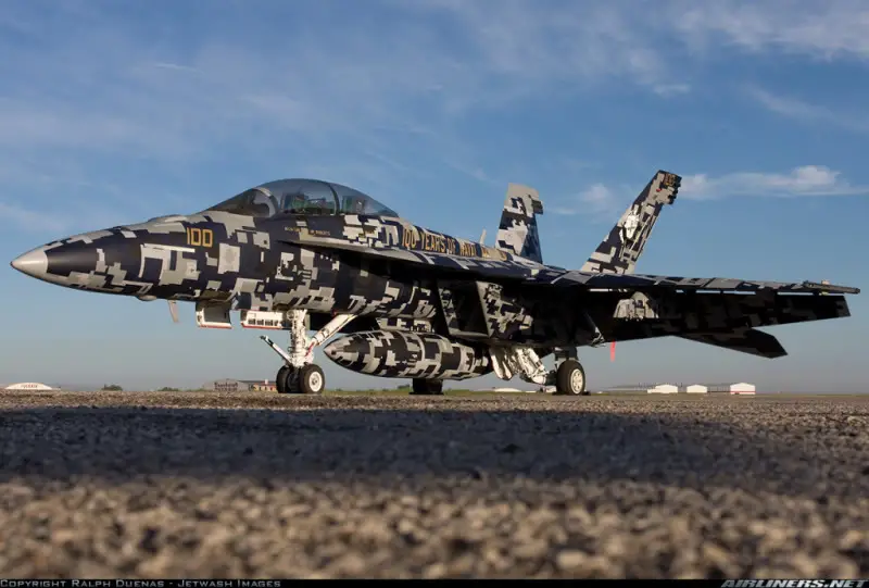

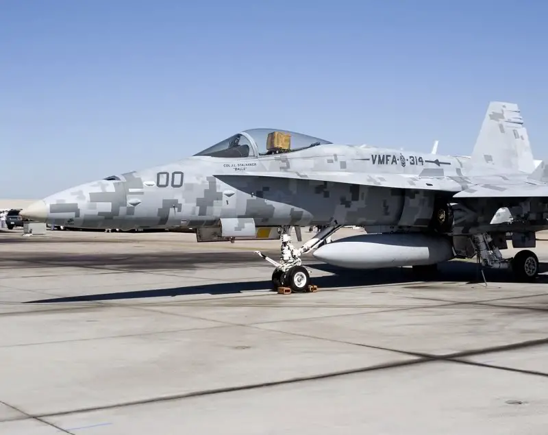

Make sure when you start to paint the Digi-Camo that you make your mind up about the curves of your vehicle.
You can either paint the digi to go with your curves, or you can take the time to make it blend out your curves.
with this aircraft, the painters decided to go with the curves of the aircraft. it is easier because you just lay the stencil on and paint away. it will cut your time. In the end i think this way looks sexy. the smaller your blocks the better it will look.
the other option is, to take more time and effort to make everything look like strait lines. if you look at the noses of the aircraft. you can see that one moves with the curves of the jet and the other tried to keep it blocky. i know the second picture is not a great example because its paint job is not as involved, but it shows somewhat what i was talking about. i only throw this option out because some people have different preferences.
-Dano
P.S. I plan on "Digi-ing" up my truck one day too. good luck!
Nice examples Dano! The second jet is more the look I'm going for. Straight lines, larger blocks, less "functional" but less crowded. Both look nice, but with something larger than a set of cammies, the four different colors start to look jumbled. Also, Explorers have some nice lines and I want to accentuate them, rather than hide them.
