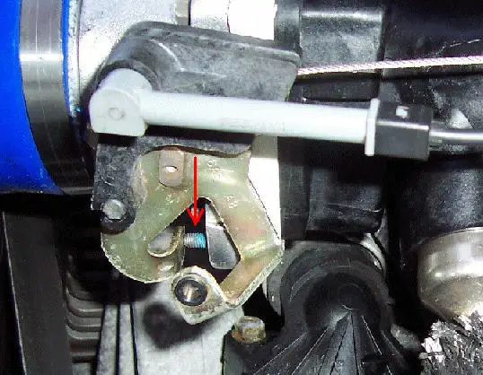

Make sure the throttle plate is not sticking open. It should be hitting the throttle stop at idle.
