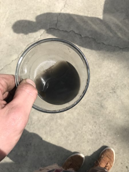

The fuel filter disconnects came off easy with a sharpie cap. Also here’s the gas that came out of it
The fuel filter disconnects are a breeze to get off compared to the fuel pump assembly line. This is partly because your in a bad position to apply pressure to the disconnect tool. and because everything is moving around. I struggled with one for over a hour with zero luck. Then I went a bought better disconnect tools and had it off in 10 seconds using the 3/8" size. I always use the 5/16" tool on the fuel filter. As I said, I don't even try to disconnect the line at the FP assembly anymore, because I've found it's just not necessary.
I ended up getting the cheap tools for the fuel pump it’s all they had. The 3/8 is what I used and when I finally got it, I had sprayed it with PB blaster and applied hardly any pressure with the tool and it came right off. It is in a very awkward spot right between the frame and the leaf spring haha
