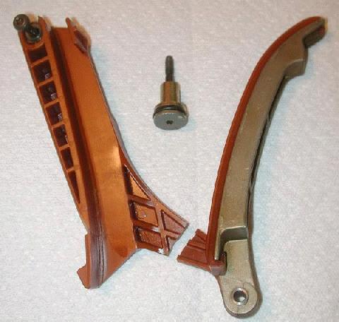

I was afraid that the timing chain may have slipped and your compression results confirm that. Your rear (right) guide assembly is probably broken.
That allows enough slack in the chain for it to slip. If it slips enough the pistons will strike the valves.
Since there is still 120 psi in cylinders 1-3 I doubt there is any valve damage. The normal way to replace the rear cassette (guide, chain and sprockets) is to remove the engine. A special timing tool kit is normally required to replace and time the camshaft.
There are probably pieces of the cassette in the oil pan and trapped in the oil pickup screen.
