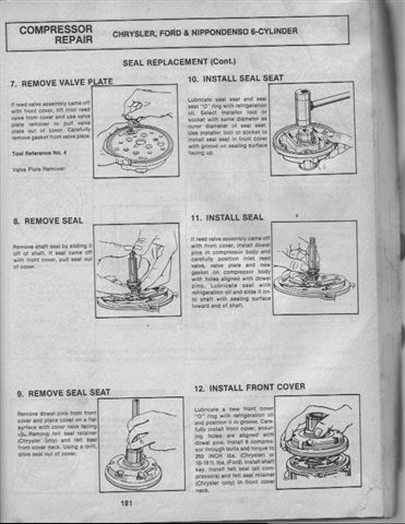

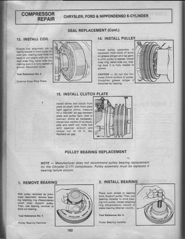

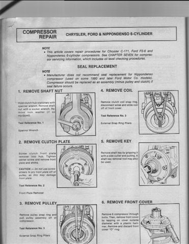

This is a teardown for the FS6 which is similar to your FS 10...
When I had to rebuild my last compressor I found a local a/c rebuilders to get the shaft seal and body o-rings for replacement...If you don't have one local, try www.ackits.com and www.aircondition.com
This guide will do a step-by-step on teardown and reassembly...It assumes that the user is able mechanically to perform this task...
It is not difficult to do...And it is a lot cheaper than just replacing the unit...
Thanks Ranger, I appreciate the help. The pages are a little fuzzy, is there any way to get a cleaner copy from you or somewhere else? I have a 1-800 fax # if that would be easier.
I scanned these pages some 15 years ago and I don't have the originals anymore.. But I have a link to a PDF and page for a similar teardown and rebuild...
