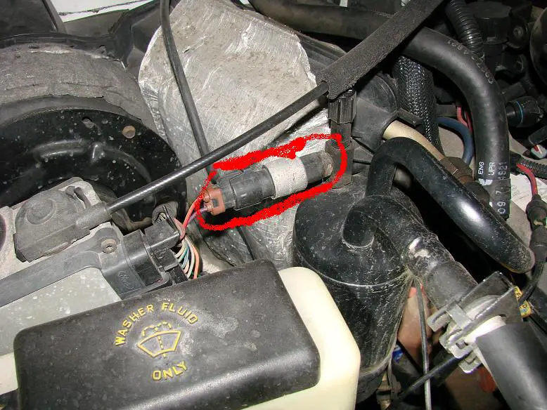

If you want to test if the clutch is working you could jump the a/c pressure switch located on the acumulator/drier. un plug and jump to see if clutch starts. It could also be a bad pressure switch, however as the others have said it is most likely low on freon.
