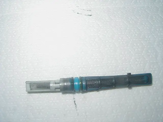

My compressor locked up in the winter of 2004. I was for sure it was the "black death", I was wrong :D I removed all the lines and the accumulator in preparation for flushing the condenser etc. I believe from the looks of the orifice tube I should be OK just flushing condensor/evaporator, lines and replacing the orifice tube and accumulator. Hopefully the picture of the orifice tube will show. What do you think?
I know it looks dark in the blue section, but the screen was pretty clean.
I tend to think flushing will be ok. I didn't see any black masses or metal slivers...
