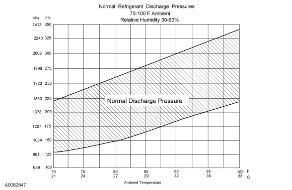

Just for reference I found the pressure charts for the A/C system from the Ford FSM using the following setup procedure.
1. Drive the vehicle or run the engine until it reaches normal operating temperature.
2. Connect a manifold gauge set or refrigerant service center with high-pressure and low-pressure gauges to the refrigerant system.
3. Set the climate controls.
4. If equipped with manual climate control, set the A/C controls for normal A/C-PANEL mode, full COOL temperature, FRESH air, HI Blower. If the vehicle has a fresh air/recirc button, set it to FRESH. If the vehicle has an A/C switch or compressor on switch, set it to A/C ON.
5. If equipped with ATC, set temperature to 60° F (15° C) (lowest possible temp setting) with the dual function disabled (if equipped). Manually set blower on high. If the vehicle has a fresh air/recirc button, set it to FRESH. If the vehicle has an A/C switch or compressor on switch, set it to A/C ON.
6. If the vehicle is equipped with auxiliary climate control, set the auxiliary controls to full COOL in the PANEL mode at HI blower speed.
7. Open all vehicle windows and leave the hood open for the test. Open the rear hatch and/or rear doors (if equipped).
8. Confirm the compressor clutch is engaged and the engine cooling fan(s) are operating or engaged. Allow the vehicle to idle until the suction (low-side) and discharge (high-side) pressures are stable or fluctuate in a range that repeats.
9. Record the ambient (shop) temperature.
10. Record the discharge pressure. If the pressure is fluctuating, record the average value.
11. Determine if the discharge pressure falls within the normal operating limits using the Normal Refrigerant Discharge Pressures chart.
High side:
Low side:
