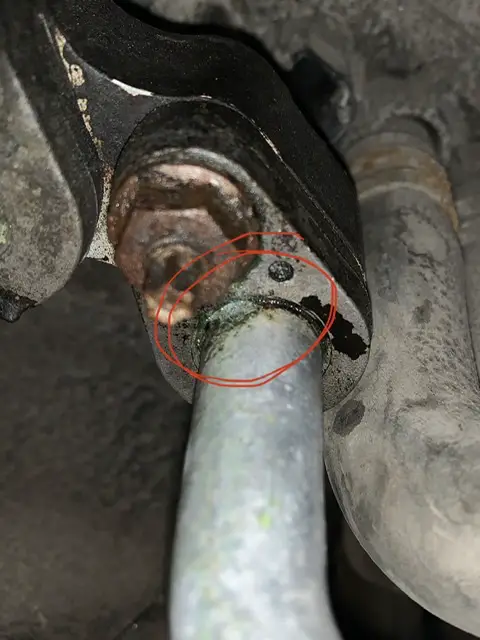

I'm going to try Alumabond or something. Otherwise I will go with the Auto Cooling Solution.

Any update on your attempt to patch with Alum Bond?
Alls well now, but PULL THE SCHRADER VALVE on the low side before you patch! Mine looked fine, but escaping gas/oil created a tiny little river channel btw the pipe and the epoxy all the way up the patch that didn't bond. Thought there was a new leak higher up days later, but sanding it down again revealed the little unbonded river under the patch, all the way down to the original pinhole.
I redid it, after pulling the valve up front, and things are mighty cold now. No leaks, weeks later. I've been all around in hot July weather, up north to the The Bridge and back, and is working great! On a blazing hot day, 50/275 PSI lo/high pressures and very cold output right away in front and back.
***I replaced the condenser dryer element right before I evacuated & recharged the system. This is best practice whenever the system is opened. The removable cap is accessible from below the condenser on the drivers side, kind of under the bumper, behind a little flap of foam. There is a cutout circle in the plastic there where you can push aside the foam, fit in a long 10mm hex socket and unscrew the cap. Remove the old element with needle nose pliers, soak the new one in PAG oil, replace it, and close up shop. Evacuate the system within 1 hour of opening the element bag or it gets too wet from humid atmospheric air.
MAKE SURE THAT YOU HAVE THE RIGHT CAP TYPE!!! THE SHORTER 2014 PLASTIC CAP FILTER SCREEN COMES OFF AND GETS STUCK WHEN INSERTED INTO A 2013 TYPE CONDENSER DRYER TUBE!!! BEWARE!!! My 2014 was given the wrong plastic cap type for 2014 and later years. I obtained the part at a Ford dealer. I had to figure it out for myself, after ordering it by VIN and given the wrong one, that its actually the metal type 2013 model condenser cap. A 2nd Ford dealer also was telling me that the plastic one is the correct one based on my VIN. You can verify yours with the pictures available on rockauto.com. I had to drill out the stuck filter screen, destroying it while installed/stuck, then pulled it out, it sucked a lot. If your condenser dryer element tube cap is metal and longer, its the 2013 earlier version. ***

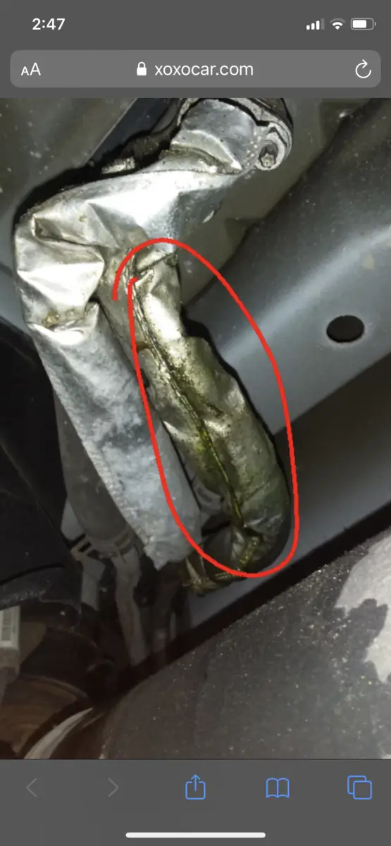

Looks like this thread is getting another one. My 2015 Explorer (80k miles) is having issues with the rear a/c. Local shop quoted me 2k to replace the rear low side hose and gaskets. I don't have any experience with repairing cars, but this price seems ridiculous just for a/c. I'm going to see if I can get another quote. Any other advice?

All I have to go off is this image the shop sent me. It doesn’t look like they identified where the leak physically was.

Difficult to tell if it is a leak at the top as in post 144 above where the fluid has run down or if it is in that short length of line that is covered. If the latter, it may be fixable.
Peter
I'm going to look at it closer myself this weekend. Fingers crossed.
Remove that silver heat barrier, leak is under there somewhere. If you cut the silver stuff to get it off, don't use a razor knife blindly and cut the rubber hose part of the a/c line. The transition from aluminum tube->rubber hose is over the muffler after the 90 degree bend.
