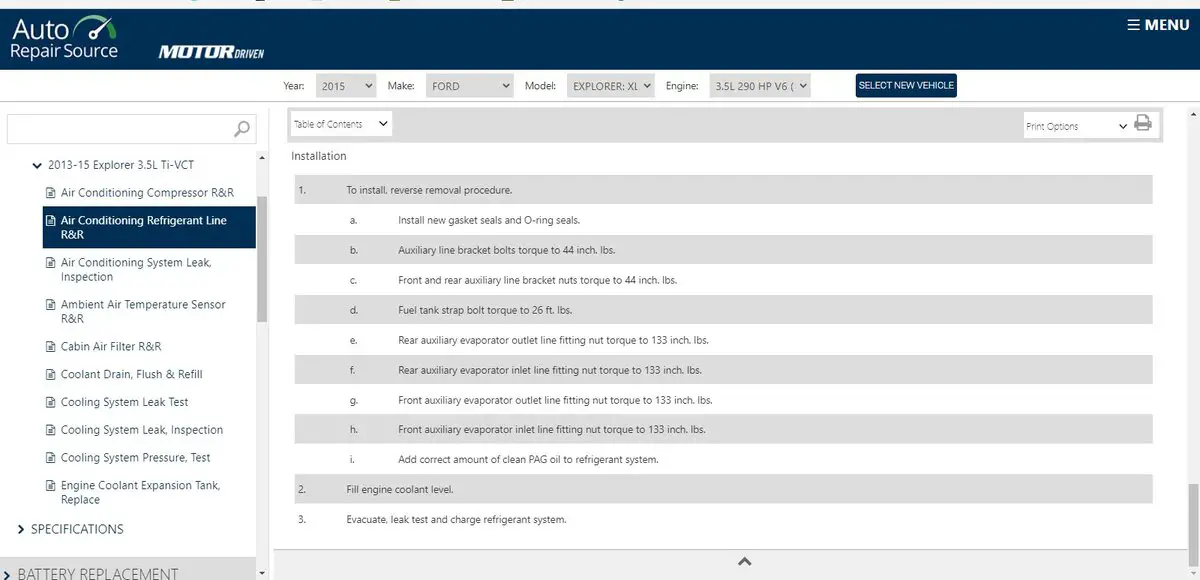

I found this on a very handy site to reference. I access it through the library's MelCAT system. Its a site called Auto Repair Source.
I find it odd that it states to add the PAG oil and THEN evacuate the system, check for leaks and charge refrigerant. Could this be due to the assumption that one is using a professional extraction machine which filters out the impurities and adds the R134a and PAG oil back into the system?

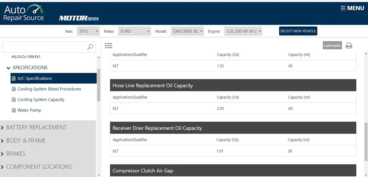

And there is this chart which indicates how much PAG oil to add for each type of part replacement. It too must make an assumption that the only PAG oil lost is that left inside the component, which in this case are the 2 aux refrigerant lines.
Again any insight would be appreciated.
My understanding is that the vacuum pump does not pull out the oil or not enough to cause an issue. The oil is a liquid and the pump is mainly pulling a static vacuum, so there's no real air flow to pull the liquid. The gas is suspended, so it can be pulled out.
Another reason to add the oil first is after you evaccuate and check that it holds the vacuum pressure, you charge it with refrigerant without opening the system. It would be difficult to near impossible to add the oil without breaking the seal and exposing it to moisture.

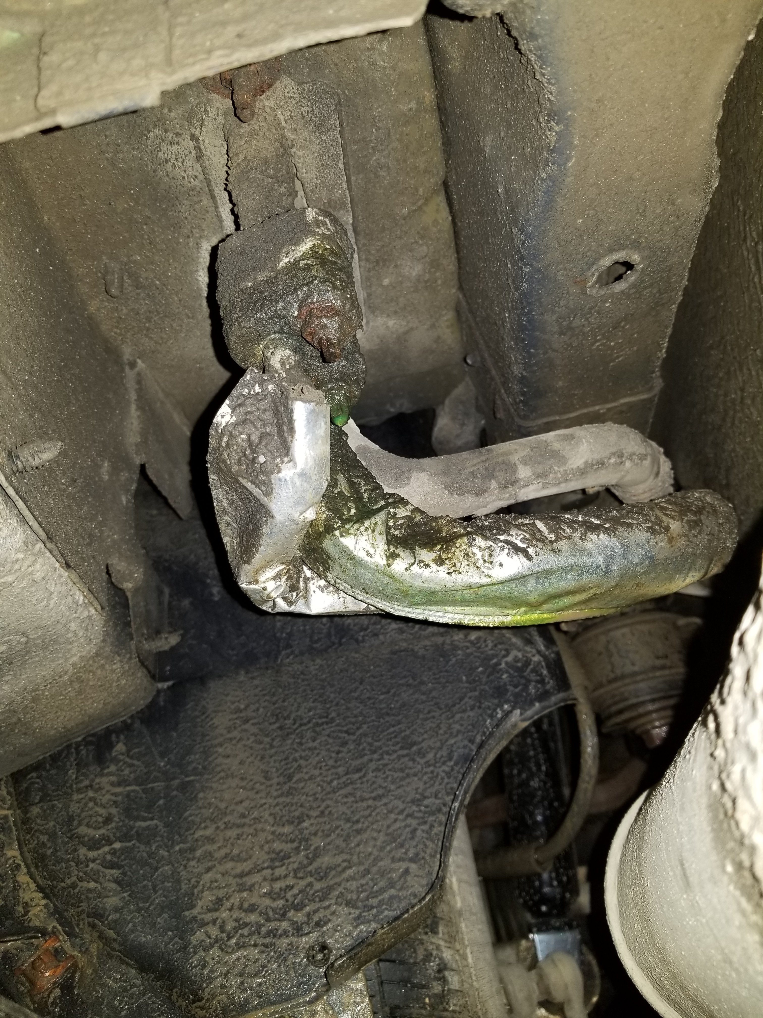

I watched this video as well. Its only a very small percentage of vehicles which have failed seals. Most have leaks in the line itself. A common failure point is where the line meets the fitting.
Where the arrow is pointing is the failure point. Ford engineers got this one completely wrong. They have rubber hoses under the fabric heat shields. The idea is to give the lines some flex for travel of the suspension. The issue is that due to the flexing it creates a weak point at the joint. Its the same as taking a metal coat hanger and bending it gently back and forth. It eventually becomes weak in that area and will break.
The common opinion is that its corrosion from road salt, but I call bulls*&t. If there was going to be corrosion it would be where the aluminum line connects to the rubber hose under the heat shields. Mud, water, sand and salt collect inside these sleeves and stays there. Its like keeping it under salt water for years.
Just my 2 cents. If you haven't already, buy the UV dye and a UV flashlight to be sure its the seals. I did on mine and detected zero UV dye at the seal/joint. There was plenty at the stress point.
Best of luck with your repair. BTW this isn't an actual picture of my Explorer. I found this one here on the forum.
