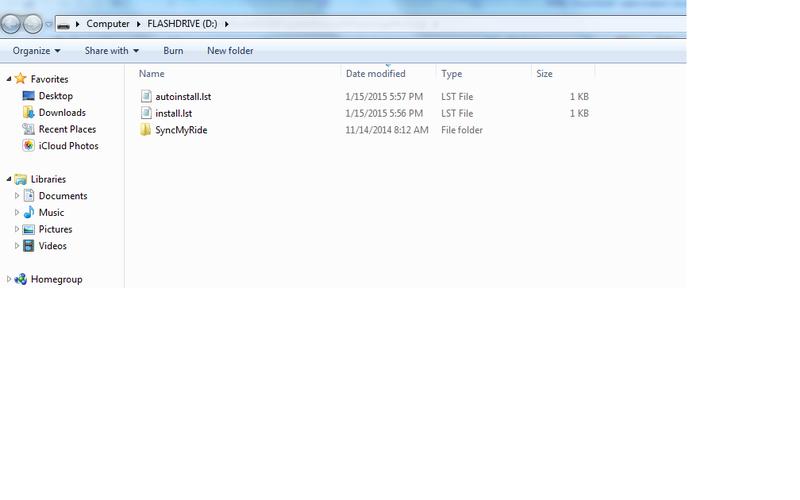

Was the zip file you downloaded named: Gen1v441buildEE309Fupdatefromv430FpackageRev2.zip ?
I mean putting the zip file on the flash drive... Yes it was unzipped
So when you put your flash drive in your computer and open it, it looks like this then....?

Thank you for the step by step!!! I did E-mail you a pic of the file on my flash drive :) Thank you so much for all of your help
