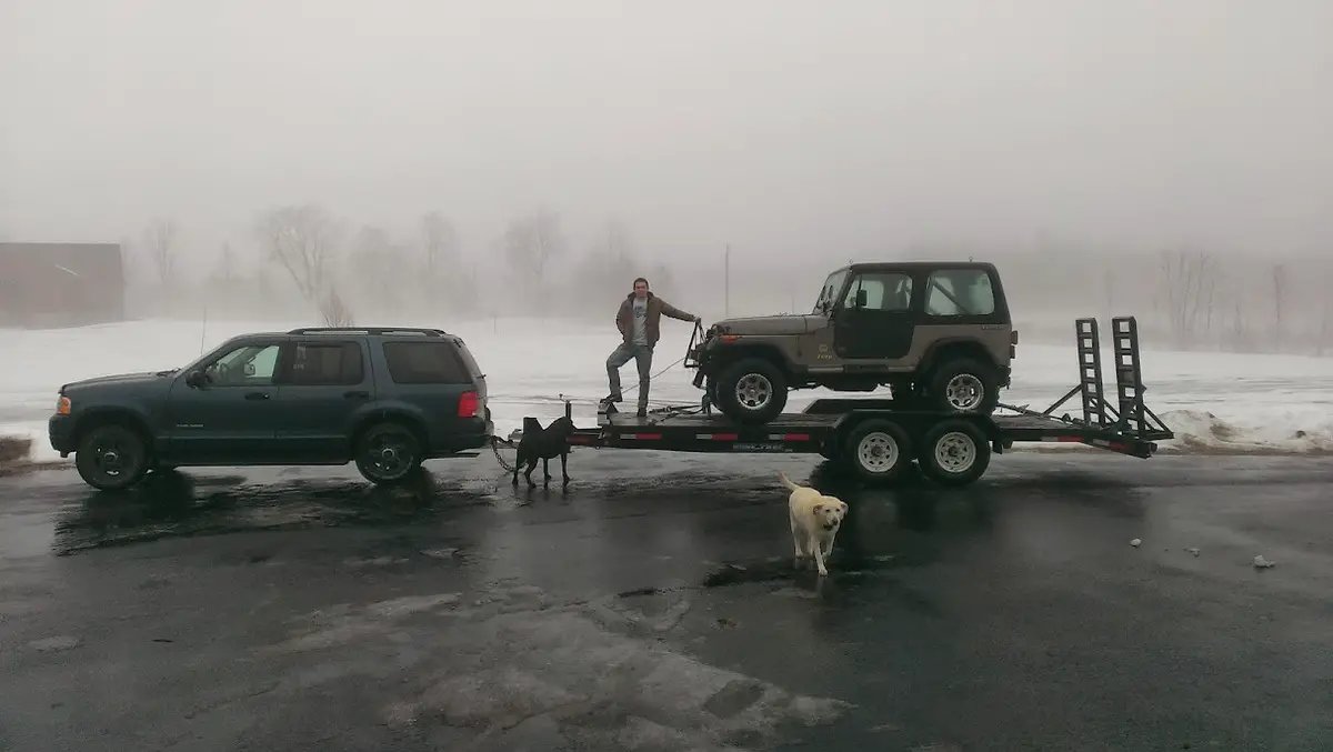

The verdict: Holy crap was I wrong!!! First off, I didn't have a hitch that was quite low enough for the trailer. This meant that on the way there it was bouncing around on the hitch a little. The trailer is a 20' Equipment trailer that is 3150lbs and has an 8950lb capacity. Once I got there and we loaded the jeep I was quite pleased with the relative lack of squat.
Challenge one.
Merging onto the highway. The spot that I had to merge into is uphill and a place where a lot of traffic all meets from 3 directions and there is an exit off the entrance ramp. It is weird. This had me worried but, without breaking 4k RPM I had us up to 60mph no problem up the hill and I was a little surpised.
Challenge 2. Bumps
The section of highway that I was on is SUPER bumpy. It is in need of a repave big time. The stability issues that I thought the combo would exibit did not exist. the truck handled the weight fine really, no issues through the bumps and no swaying WHATSOEVER.
On the next miles on the highway I was sustaining a very comfortable 3k rpms and the motor was really not straining bad at all even on the hills. I BARELY had to downshift that trans really knew what the heck it was doing.
The big challenge. The hill
I live around a valley so tons of my driving is on steep hills. There is a road that I decided to take (my usual route) that climbs about 500 feet in about 2-3 miles or so is is VERY steep. Though I don't know the grade of the road I can tell you that it is one of the steepest roads I know about and it is well over 7% grade in areas. As I climbed the hill I held 25mph and about 4k rpms with about 50-70 percent throttle. This honestly shocked the hell out of me. I think foot to the floor I could have held 30 or maybe 35 which if you were on the hill you would have been impressed believe me. Nothing overheated or moved at all she just chugged up the hill perfectly.
Conclusion: I must say that I am very pleased with the performance towing of this thing. FOR WHAT IT IS it is a great tow vehicle....FOR WHAT IT IS. It isn't a pickup truck or a full size SUV but it will hold its own and get you there safely. As for the v6 having a tow capacity of 5300 and the v8 6900 I think that the numbers are crap. the v6 is 20hp/tq less than the v8. EVERYTHING ELSE IS THE SAME. I don't see any reason that the v6 can't pull 6k no problem and even the 7k that I did I would do again without thinking twice about it. I would aoid really hilly areas but that being said in a drag race with 7k pounds behind both I think the v8 would only perform a little better to be honest.
That being said I would NEVER tow over the 7k mark with this thing. At that point you are going over what the vehicle is rated for. It is one thing to sacrifice a little power being that again, the rest is virtually the same, but if you go over that 6900 mark you are endangering yourself and others so don't do it.
Lastly, I know that towing something once and for limited time is not a great test to make all of these claims on, but, considering the road types and conditions I feel that I can make an honest assumption on the performance of the vehicle here..so I did.
Double lastly, I do have some slight intake modifications to the intake but thats it. Otherwise she is bone stock.
Drive safe everyone and I hope that this helped someone out.
