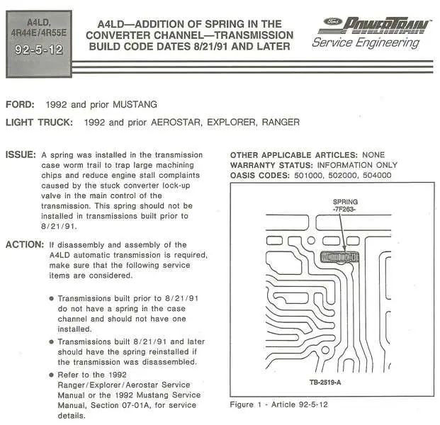

winner winner chicken dinner!!! took the vb off and found problem, just hope its fixable. went and got transgo kit. found broken pieces of spring, small diameter between vb and steelplate. any way you could identify by sight brooklyn? hoping it isnt the clutch spring that broke. heres my number if you can call bb. 702-308-5876 name is brad. or anyone thats a trans guy.

thats what it is !!! next question.....do i need it? can i run without? what happens if not there? is it possible it went farther into trans (i.e. clutches etc.) and caused more damage?
if it was a tsb then i think i should prob. try to get another. by the way brooklyn i cant thank you enough for all your help. i couldnt or wouldnt have done this without ur guidance.
Ford doesn't sell this part anymore, but here's the part #: 7F263. This is the TSB:
well, maybe its not the filter spring in my case. it says not to use prior to 91, im a 89. i hope its not the drum springs. found some of it on top of sep plate,most inside vb. i dont know? wonder what it is. we will see if vb rebuild fixes my prob. let you know this afternoon.
I've found these springs in older models that were rebuilt. Sometimes they were added during the rebuild. There was a production change on the solenoids. This is the only difference that I could think of at the moment. Take a look at the comparison of the two solenoid designs in this link: http://www.teckpak.com/teckfitz/products/pdf/solenoids/k56836a-b.pdf
