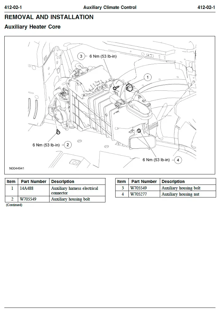

I'm betting it's leaking from the Auxiliary Heater Core, or connection to it. You think you might want to tackle that? It's located behind the left rear wheel well. Might want to check your coolant level.
You've already exhausted that possibility? Auxiliary A/C "drain" would be in the same box.

Whats involved with the Auxilary Heater Core? Coolant level looked fine last time i checked.
Auxiliary Heater Core: REMOVAL AND INSTALLATION
You're not really pulling this unit out, just looking for source of the leak. Keep an eye out for stained areas that might point to a loose fitting, cracked hose, or leaking core, etc... Maybe even a plugged drain!
