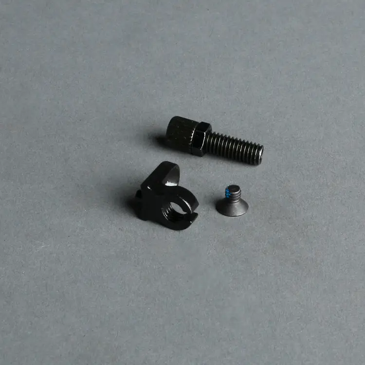

Off to the bicycle shop for one of these:
90 degree slotted cable stop... ..
Just clean up the broken push-pin jigger so the cable end is roundish.
Do not try to pull the plastic end off the cable (it is glued onto the cable sleeve) you'll just make things worse.
From there slip the cable through the slot and secure to the control head with a screw and nut. (hardware store) you get the idea... .
The "slotted hole" is threaded and is the right size to actually thread the cable end into it, to prevent movement in both directions.
It's a bit of a fidget but it works, permanently, ask me how I know.
It's no surprise to me that someone else here has already run into this. I just sat scratching my head trying to figure out a good solution. Not being a biker, either, this naturally didn't come to mind.
But yeah, this looks pretty much perfect for what I need.
Thanks.
Paul
