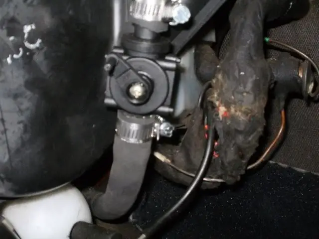

Another simple bypass of the problem is to install a valve in the coolant line to the heater core. In years before blend doors it was a common solution to heater valves that leaked hot coolant through the system. A simple 5/8" male to male valve is available at most any hardware store or auto parts store. Simply cut the heater hose and install with a couple clamps.
