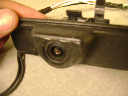

Here is an image of the OEM camera within the mounting frame.
Second picture shows how the camera wiring harness is integrated into the back up light harness. Both end in the orange connector.
Four connector pins without camera, 8 connector pins with camera. What I don't know yet is if the Lift gate harness has all wires anyway.

Yes, and I did discover that the wiring inside the lift gate is different with and without OEM rear camera. The camera wiring is not present unless the vehicle is so equipped from day one. So basically you are left with doing a wireless setup of fishing a new wire overhead. Also you will need to fish a wire from the camera to the backup light circuit to turn camera on. Good luck.
