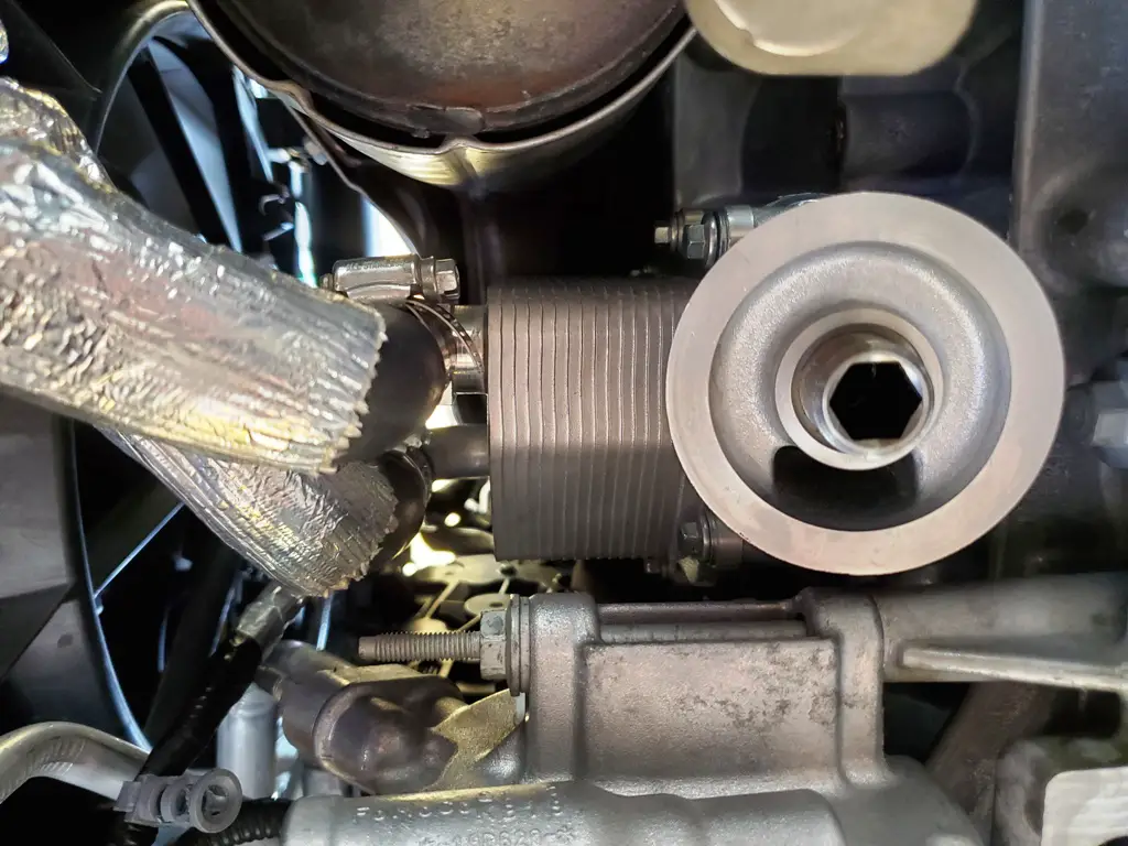

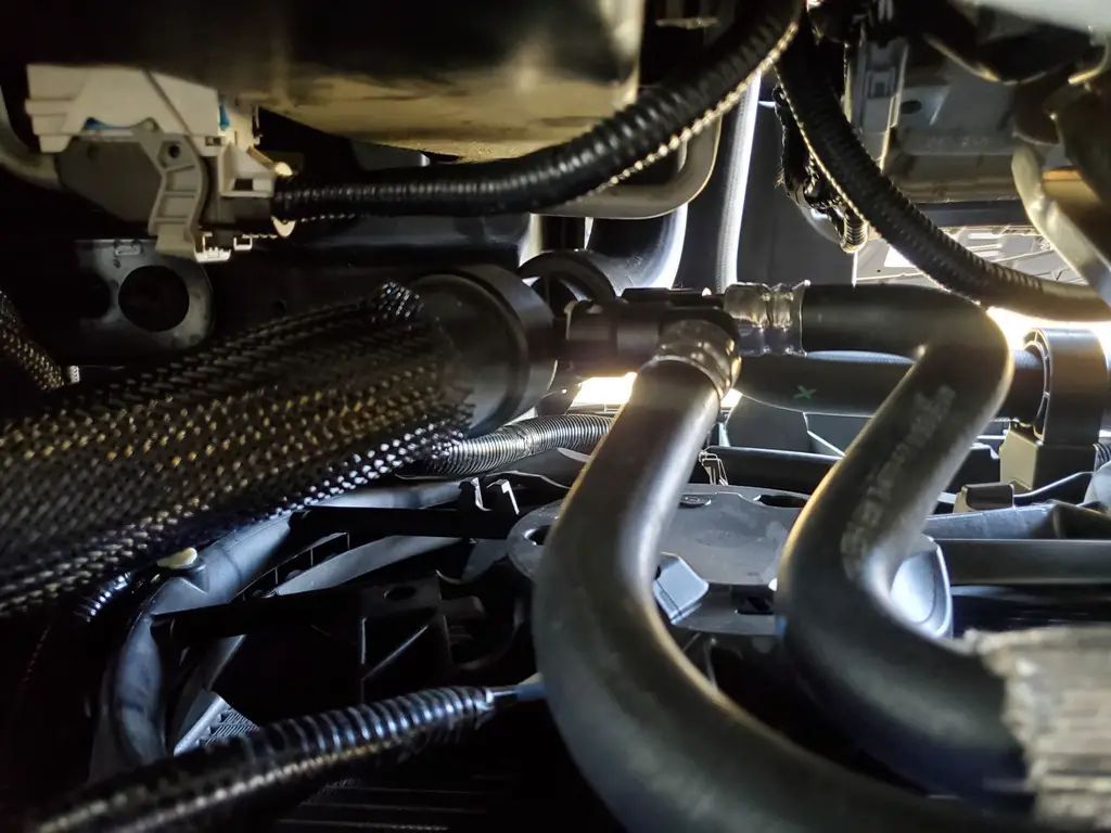

Added a factory engine oil cooler to my 2018 XLT 3.5. Pretty straight forward except for finding the correct radiator hose with dual connections. Actually bought it at the dealer ( $56 ) after searching on line ($85).
Very little room to get the top 3 bolts started, but other than that pretty easy to do. I'll share the cooling diagram to save anyone doing this mod the grief.

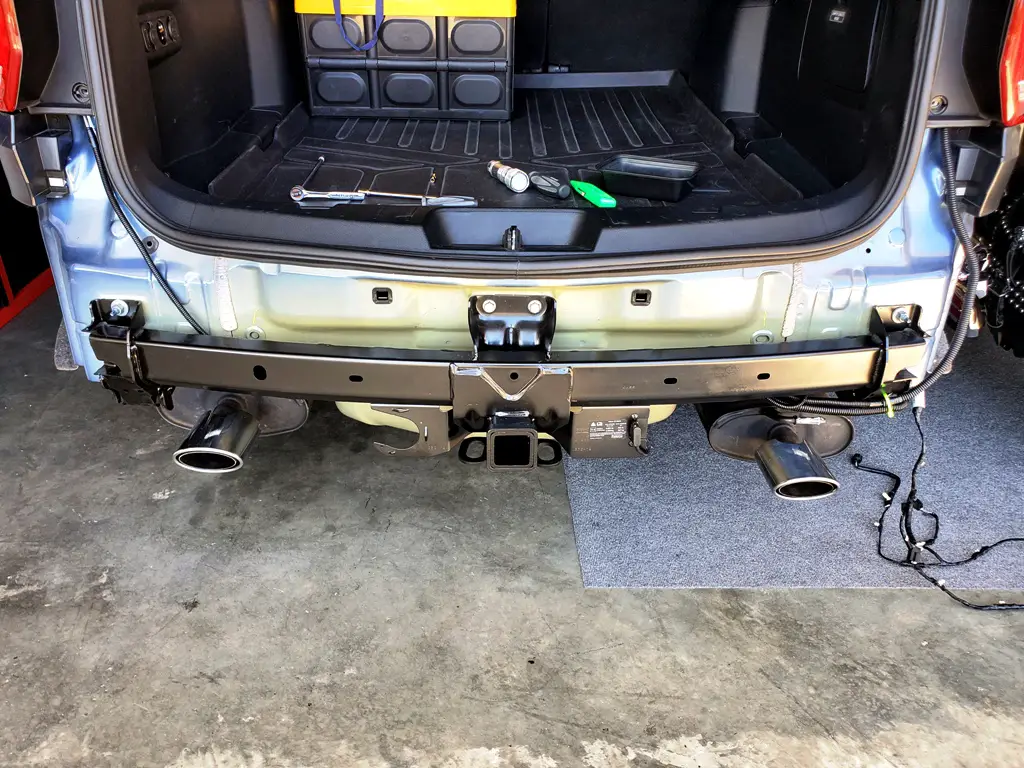

I love the diagram, and will add it to my own files; thanks! I also recently finished adding this very same equipment on my own 2018 3.5L XLT, as part of adding almost all of the factory tow package parts to my own vehicle!
I removed the rear bumper and fascia, and replaced it with the Ford OEM 5K-lb trailer hitch kit; then replaced the rear lower valence with the factory valence that comes with the tow package, for the factory "hidden" hitch look. I then also installed the factory "Tow/Haul" switch and panel in my dash... and finished it all off with not only the OEM oil cooler items you show above, but also replaced the front bumper lower valence, to accomodate the cooling air duct kit that is also part of the factory package. (I've done some other write-ups on these projects here on the forum).
The only thing I could not upgrade was my 6F50 transmission with the "6F55" version, which I've learned has a few beefier internal running parts to help it meet the maximum-rated loads a little more confidently.
Anyway, thanks for the great diagram!

Another observation that I've forgotten to mention in my postings is that the aftermarket tow hitches typically only mount with 4 to 5 bolts underneath the rear, whereas the OEM hitch actually mounts using a total of 12 bolts... 6 underneath and 6 on the upper rear body structure... certainly a much more heavy-duty way to mount it, strength-wise. Again, I'm just sharing an observation, and I do understand about the total "tow rating" question, regarding having it all installed at the factory in the first place.
