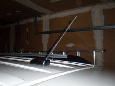

What kind of antenna do you have? Does it look like this picture? If so, I wonder if you may have the antenna you need since in vehicles with Sirius, the antenna is in the base. Unfortunately, I don't know how to verify that. Sirius is optional on the base model so perhaps the same antenna is used for all.

that's the antenna I have, but I'm ditching that regardless for a "hidden" antenna for my work UHF radio.
