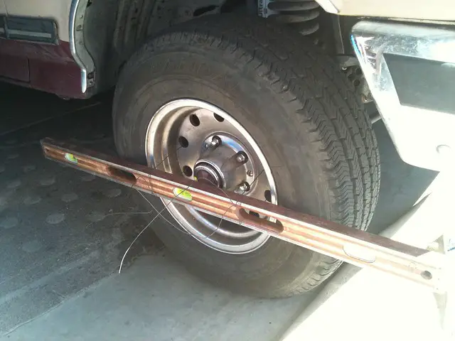

I use 4' framing levels hung by a string on both tires, and position the levels so they are level in the middle of each wheel. Using a tape measure, I measure the distance between front and back side of the tires. Setting the toe at 1/8" to 1/4" in at the front.

Using the level method (one on each side).
DIY toe adjustment by maniak_az, on Flickr
