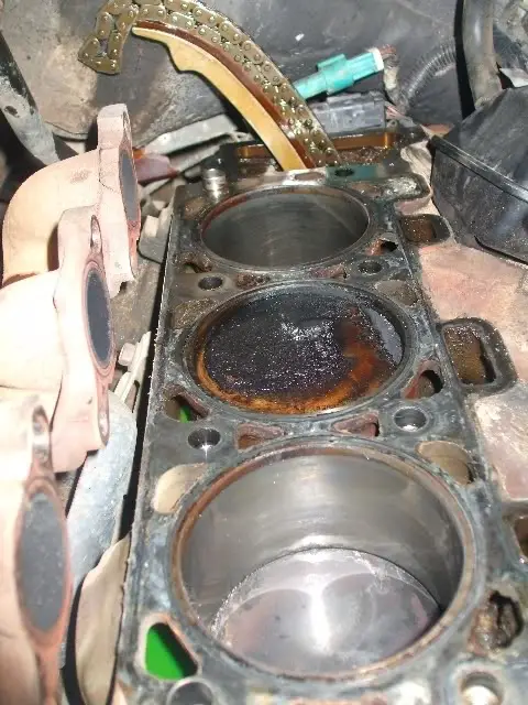

I have been going over my engine for the last few nights as I had a few problems pop up such as a water leak, vacuum leak and a rattle in the engine to chase down.
I removed the front timing cover to repair the water leak and found what was making my engine rattle. The balance shaft tensioner has broken.
After a compression test I had only 105psi on cylinder no#2. I suspected valves so I removed the head only to find that the no#2 cylinder does not completely come to the top of the block on it's travel. I guess this is the cause of low compression in this cylinder.
I know the crank shaft is strait, the harmonic balancer doesn't wobble at all. So my best guess is I have a bent connecting rod. Looks like I will be pulling the motor for this one.
Cylinder no#2 covered in burned oil. the piston sits about 5mm from the top of the block at it's TDC position. You can also see my rear timing chain with no guide, I may as well put in a new timing chain kit while I have the engine out.

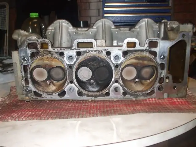

On closer inspection the valves and stems look ok, I'll give the heads a good polishing in the mean time.
I can't believe it, You can actually stand in the engine bay while you remove the heads. I love American Vehicles!
