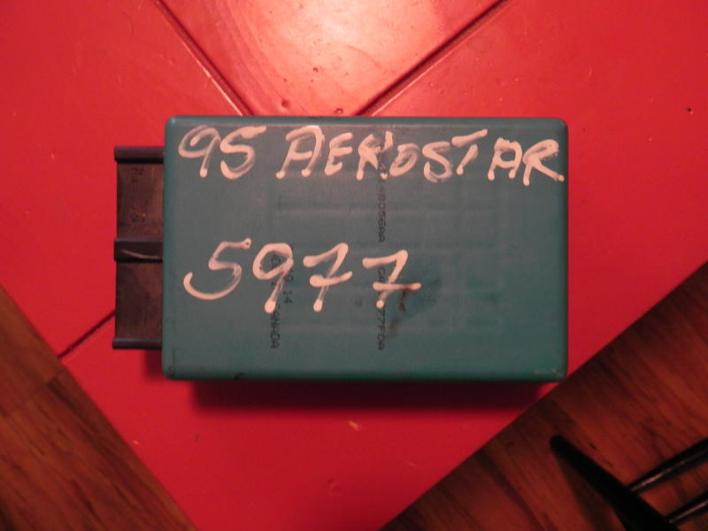

well I just went and unhooked the battery and when I when to pull the computer harness the whole box fell out and had part number hand written and 95 Aerostar in white paint it must have been replaced theres a picture of it

It's a junkyard part. I would suspect that it's defective. You should try cleaning the contacts anyway just to see if it makes a difference.
I did just that i cleaned it up and reset the computer and so far no blinking air bag light i drive it mostly every day so ill keep a eye out on that light
