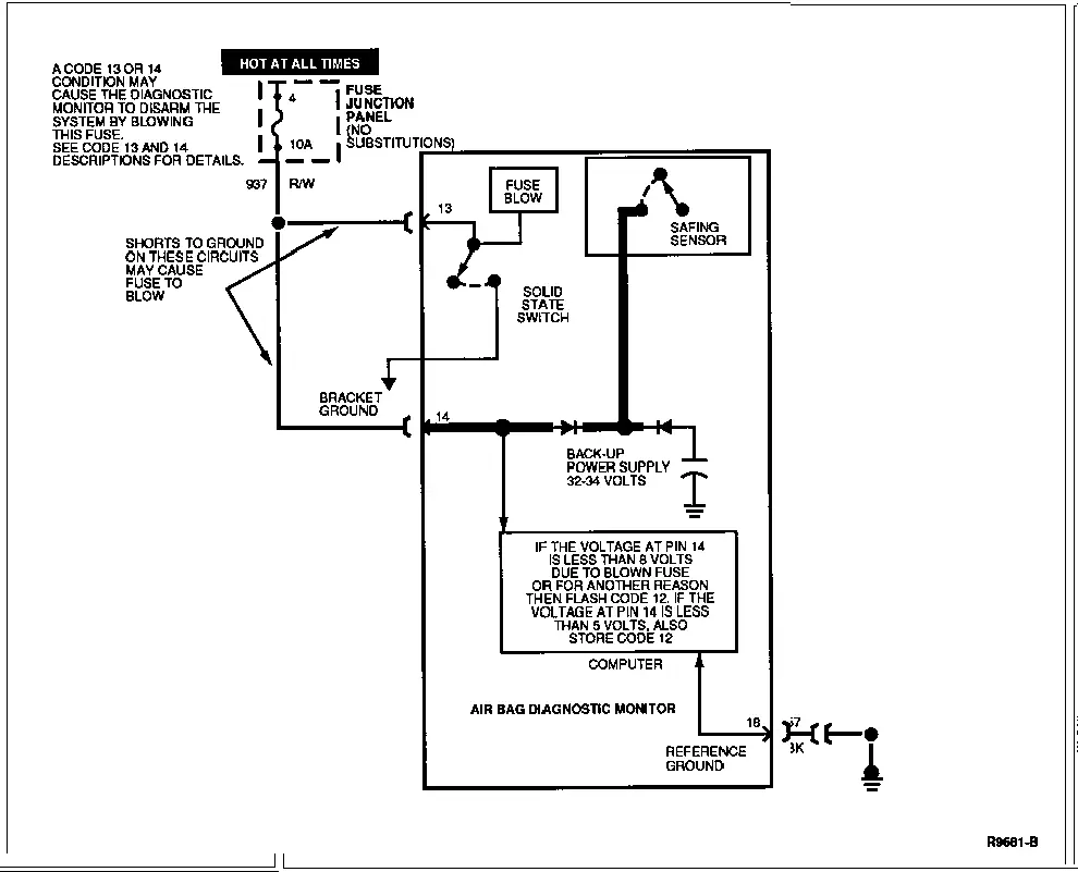

A couple years ago I was driving and all of a sudden my air bag light came on and it started beeping.....it has been on ever since and beeps every once in a while but the air bag never came out. Has anyone else had this problem? I was thinkin that it may be a wiring problem. Also, sometimes when i turn my blinker on it smells like something is burning and smoke comes out of my 4 way switch. The dealership said it would be very expensive to pull out my steering wheel and fix. Just wondering if other people with 99 explorers have had this problem.
