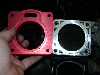

Here's a picture I dug up of the Poweraid Part # 400-507 that should fit a Job 2 model and of my Job 1 ST's throttle body. The difference is obvious.

The part number I got was 400-507. 400-598 doesn't fit, because it has the throttle linkage on the right (facing the engine), while mine is on the left. However, check the Airaid in the picture: the gasket goes around the intakes, in an oval shape. My TB has one round gasket completely surrounding the main intake, and an extension going around the secondary. Kind of an 8 shape, so there is a rubber gasket between the intakes. Look at the picture: there's nothing between them, because there used to be a metal plug. That changed, starting with 08/01, according to Ford, but, aparently, earlier. Waiting to see if Airaid people will come up with the new part, with the 8-shape rubber gasket.

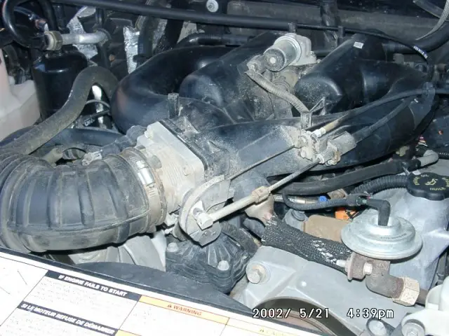

Here's a picture of my Job 1 4.0L with the Intake Manifold cover off so that you can see the throttle body and linkage better. Notice the linkage is on the driver's side.
