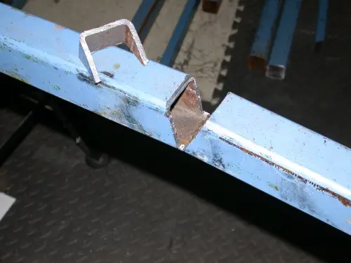

By welding it to a stock bumper with the ends cut off (ala Froader style) but with a single tube bent around the corner.

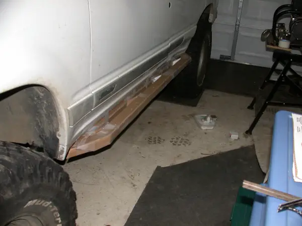

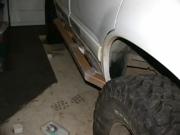

More mock-up

Nice. I like the design. How do you intend to mount it to the frame? Bolts or Welds? Either way, be prepared to drop the gas tank for fire safety or access, depending on the mounting choice. I mention this now as it is something to think about how much gas you currently have in the tank :D
I'm thinking of bolting to the frame. Will have to bend up the lip at the bottom of the rocker to keep them nice and tight. I'll add a layer or two of rubber pond liner as a buffer between the sliders and the body so the body pucks can still isolate it from the frame.
I also plan on cutting up the original plastic running boards to cover the holes and maybe the lead-in --- lead-out by the fender wells and use the original black tread on the top of the outter tubes. That should make them look pretty close to stock :cool:

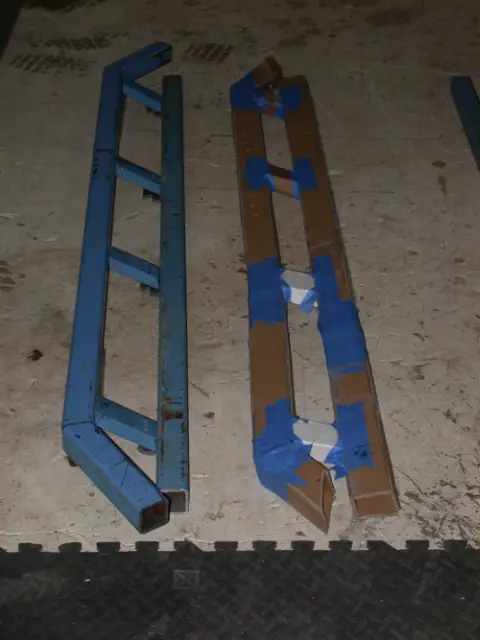

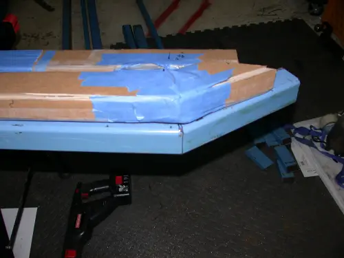

OK, let's see. I left off building sliders (this is going to take a while to catch up);

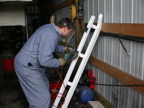

So, I had them welded up by the mechanic of one of my contractors, then Herculined them WHITE :D

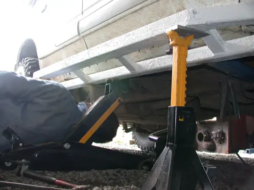

A little trip down I-5 to Joe's place and he was kind enough to weld them on.

Did you just weld the box tube to the frame? any gussets to make it stiffer? Looks like 2x2x3/16" box tube. Have you tried to tear them off yet (on rocks and such)? I know I need some sliders already after only my first run, lotsa nice wrinkles under the body already. I may do top sliders first cause that where the first dent was.
Sorry Iron man, I forgot you asked.
No gussets, welded straight to the frame.
I haven't hit them really hard and don't plan to but I have sat on them with big a 'Thump' a few times and was very happy to have them. I must have used them several times cause there are several scrapes on the underside.:cool:
