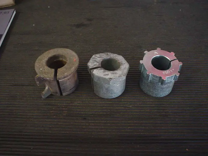

The eccentric's can be bought through Firestone when the alinment is done, but will cost extra for the part and install labor, the same will be true if you go and buy them at an auto parts store.
The eccentric's control caster and camber on the TTB frontends, if you need 3 degrees, they may not have them in stock, and you will have to wait.
It's is not a correct picture, but similar to what you will need:
I'll get a better pic of the eccentric's while I'm at work today and post it tonight when I get home.

The picture below is what the eccentric's look like to correct camber and caster on the TTB 1st gen Explorer (2wd or 4wd), yes they are different for 2wd and 4wd but they look very similar.
Not sure where you all are getting this "shim" hogwash from, but then again what do I know it's not like I'm a technician or anything. :rolleyes:
If you look closely at the different eccentric's, you can see the offest for the upper balljoint.
The first one is a stock unit (non-adjustable), the second one is infinately adjustable, and the last one is indexable.
You will not know what eccentric's you will need till it is up on the alinement rack.
