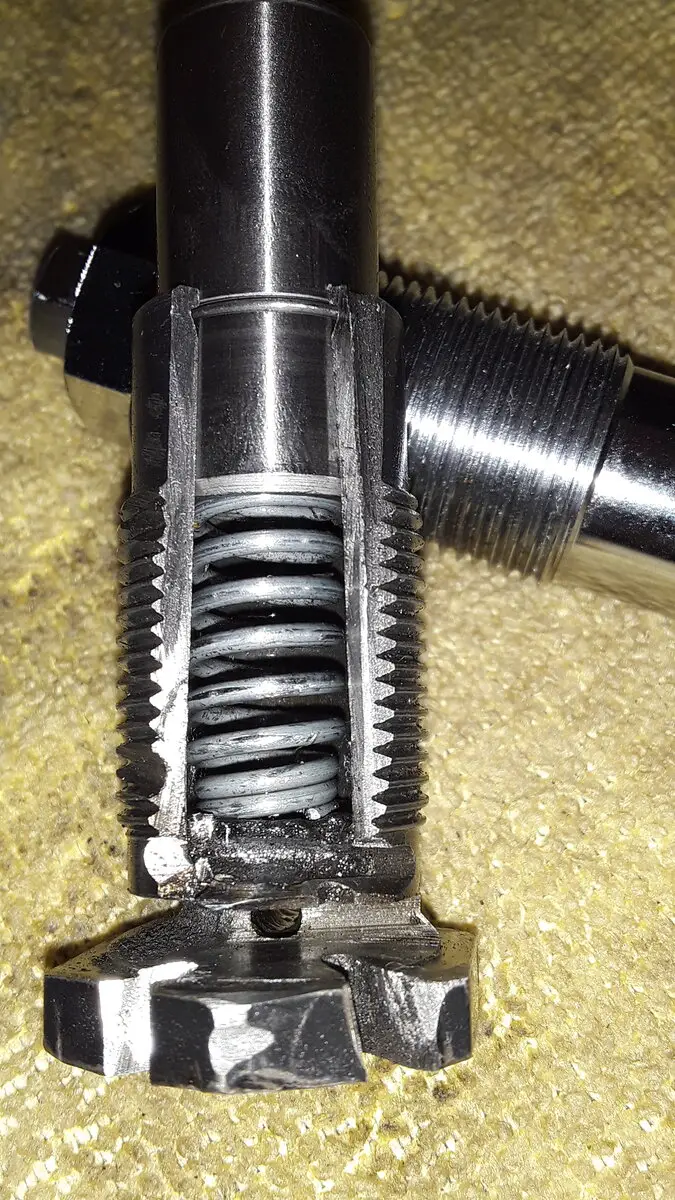

coolant, tstat (for the 4.0s), replace the tstat housing with the metal Simmonz autosport units, while youre at it do the timing tensioners and maybe change plugs/wires depending on miles... thats about it i can think of!!!

I'd change the tensioners only if you have noise

i think in. his new member into thread he mentioned diffy and hes getting the trans worked on, so i presume new fluid... and doesnt ford spec a 75k tensioner interval? or am i hallucinating o_O
No. Members tend to replace them at that mileage for preventative maintenance
I say if it ant broken no need to fix it
Keep em clean with oil changes
I haven't been able to find a actual spec on that
If someone has it show me please
oh ok ;) i didnt replace mine until 310 k:oops:

No timing chain rattle not gonna worry about that for now. This version of the engine is supposed to have fixed the earlier problems with that. I went through the maintenance guide and no mention of ever checking it.
