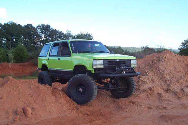

Sliders go under your rockers where your running boards are now. Mine are made out of 2x2 and 2x4 steel. I put a picture of mine below. Unlike what you would probably want to do, I cut all of the rocker panel out and put my sliders where they were. It allowed me to get rid of my rotting rockers, and I gained a couple inches of body clearance with no additional lift.

I did not cut into the door jamb portion at all so everything still seals up fine.
Here you can see how I cut it out. This is on a 1st gen...i have no clue what the rockers are like on a 2nd gen. You can see there is still some cancer left over. I would like to graft some new metal in there one of these days but I blow through thin stuff like butter with my arc welder. I'll need some practice with that. Anyway, you can see i left around .25-.5"s of rocker in there.

I used 2x2x.187 for the "posts" that go to the frame, 2x4x.187 for the slider portion, and the frame mounts are 6x6x.25 plate steel.
