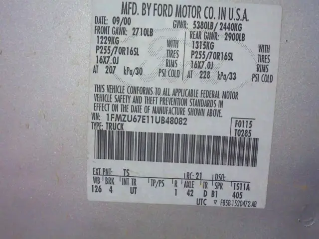

look at the door tag, under axle, find the code for what axle you have , let us know ,,

this is the sticker

Being that you only have a 2wd you don't have to worry about having to match the front and rear gears like us with 4wd's do. Since you have 3.73's I'd move upto a 4.10 with a locker and call it a day.
4:10's and 33's would be fine if you already swapped up to them from a 3:73,, but with 4:10's stock, going up that many tire sizes would not be great,,
