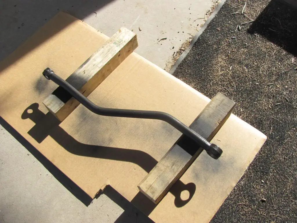

Thats just the original track bar mount but the bolt was already cut off for som reason. So it will be coil sprung.
Finished painting the axle and track bar today.:thumbsup:

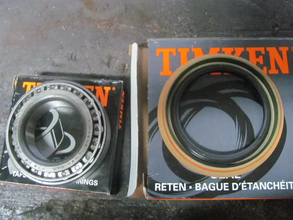

Got some brand new wheel bearings and wheel seals. Hoping to get them in sometime this week. This week i am also getting some new brake lines. I do have one question. Can someone who has done an SAS before tell/show me how you ran your brake lines from the master cylinder to the axle? Thank you.
