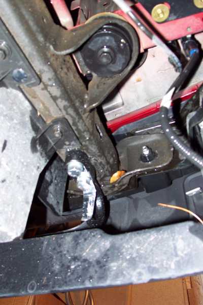

Jefe has towhooks on his 2000 XLT, however he has a bodylift, i dont know if that plays a factor or not here is a pic i stole from him
How do you get a strap to those hooks? Through the airdam, or under the truck? And yeah, he's probably able to do this on his 2k X b/c of the body lift
to me, those pics look pre bodylift, but i could be wrong...shoot him a pm or an email, he is a cool guy, i am sure he would help you out.....
Those hooks look like they are behind the bumper. If he lifted his bumpers too when he did the BL, then I can see how they wold work, but like that, they are not accessible through the bumper. I'll ask him.

That pic IS pre-bodylift. The hooks were actually very accesible (but hidden) through the hole in the bumper.
Dead Link Removed
I used them quite a few times with no damage to the bumper.
Now that I have the 3" bodylift, they hang just below the bumper, although I had to cut slots in the bottom to get to them.
