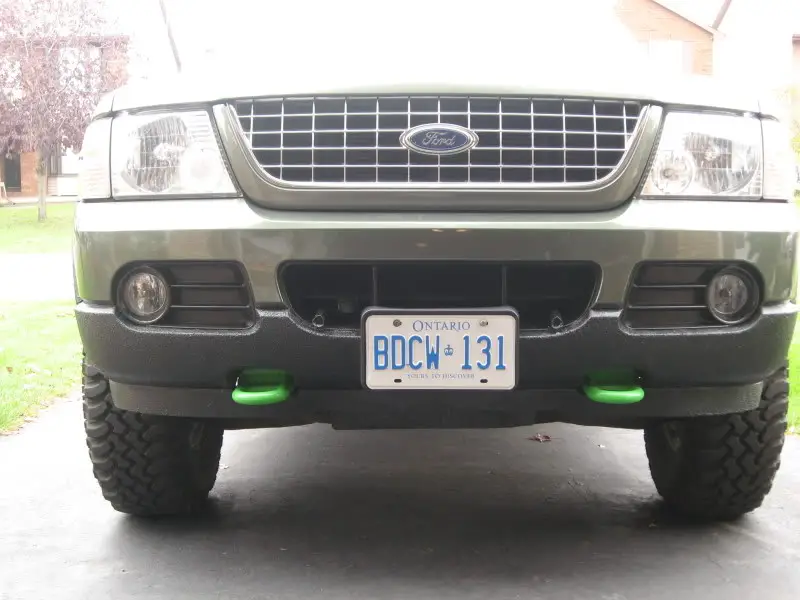

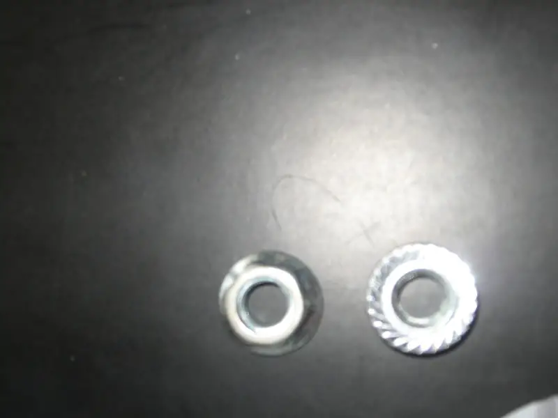

I used special nuts that were suggested on this site... they are called Flange Lock Nuts and have a serrated edge. I didn't need to touch my bumper at all, just went underneath and bolted them right on. There is not much room under there to hold the nut while you tighten the bolt, but these helped ease the process quite a bit. Pics:
The green looks mean, and i love the texture on the trim.

I forgot the size of the bolts but if i remember right 1/2 or 5/8 inch??? and 2.5" long GRADE 8 bolts/washer/nuts. I just took one of the hooks with me into Home Depot found the largest that would fit. I wound up buying both 2" and 2.5" just to be sure and returned the short ones.
No threads in the frame, i had remove the bumper cover, and bumper plate (30min) and its wide open to get a wrench in there to hold the top bolt.
2.5 inches seems a bit long? My tow hook mounts look about 1/4 inch thick and the mount on my ex is about the same?
i would really use grade 5 hardware.
while grade 8 is stronger it will sheer easier its not ment for "shock" situations. a grade 5 will tend to bend alittle before it gives way a 8 will tend to just give way.

It could have been 2" i don't remember for sure, but i did buy both lengths and used the better fit of the two, I also mounted the bolt up so any extra length would be in the frame. I also used Grade 8 washers top and bottom and a lock washer and then the nut. conig has a good point but the Home depot was only 5min away and Grade 8 because that was the strongest bolt they had, no grade 5 that I could find.

i know im late on this but... those GREEN tow hooks and calipers are **** !!!! lol also i like the textured trim as well !!
yay for and awsome job on your part !!
Danny
Danny
Thanks bro!
I definitely don't mind standing out on the roads... I get many starers and pointers!
