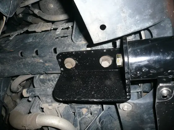

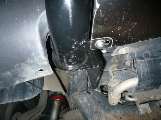

Longer bolts shouldn't be a problem as long as it is solid metal in between the head and the nut. Chris wanted to use a sleeve on the bolt to extend it low enough to get past the bottom of the bully bar. The sleeve would have allowed the bolt to bend. The brackets that come with the Westin bar do not allow for the hooks to bolt up easy. See Pics

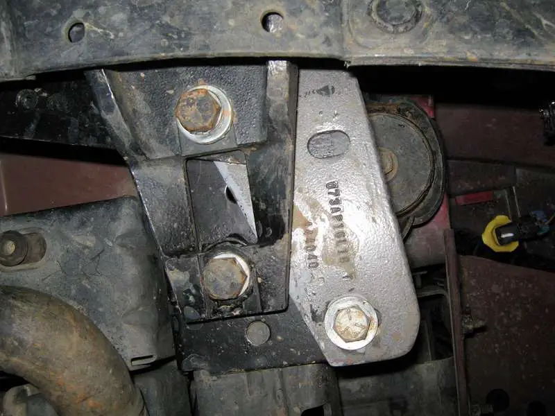

Ah, I see the issue. Mine is 3" round to the bottom of the plastic bumper bar, but then is 1/4" plate, so it sits flat - therefore, my tow hooks just sit over/under the nudge bar mounting plate and the bolt heads are flat. I also have the winch supports bolted in there too; it's pretty crowded, but very secure. Pic below (top of photo = front of truck)

Believe me, I tried. Turning the bracket would push the holes for the Bull Bar to far apart or to close together. The only way I could see it working is to modify the current bracket or make a new one. Something I don't have the equipment to do.
it is hard to see in the picture, but the bolt from the Bull Bar is not in the same plane as the ones in the frame. I though about putting them upside down but that would have required cutting parts of the frame and bumper (the metal bumper not the plastic). I also thought about turning the clips 90 degrees and mounting the side with out the holes to the frame and mounting the tow hooks side ways. I wasn't sure if it would look right. Drilling 4 holes through 3/8" metal would have taken forever so I didn't try it.
are they hardoned steal or just regular steal. if you could flip the braket so the flat piece is on the ouside we could probable mount traditional hooks to that.
