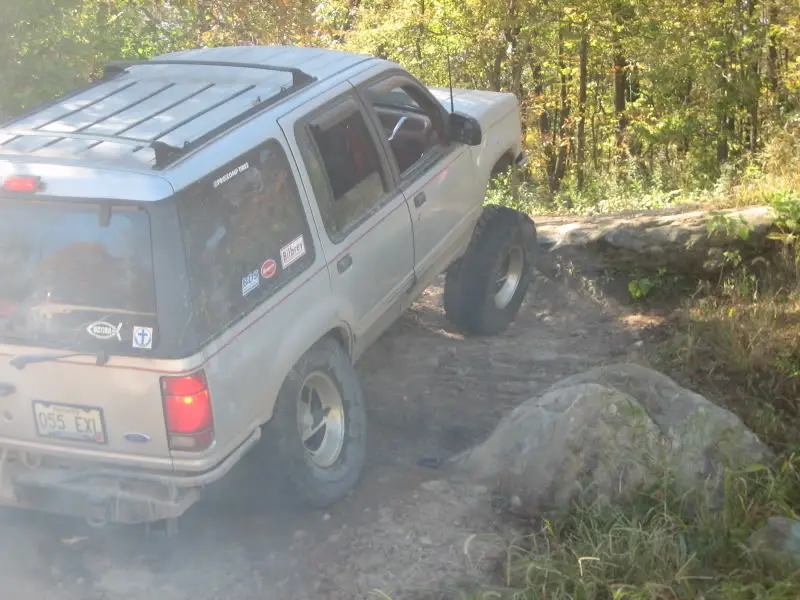

Here's another couple of pics of a 1st gen with no bars in action.
