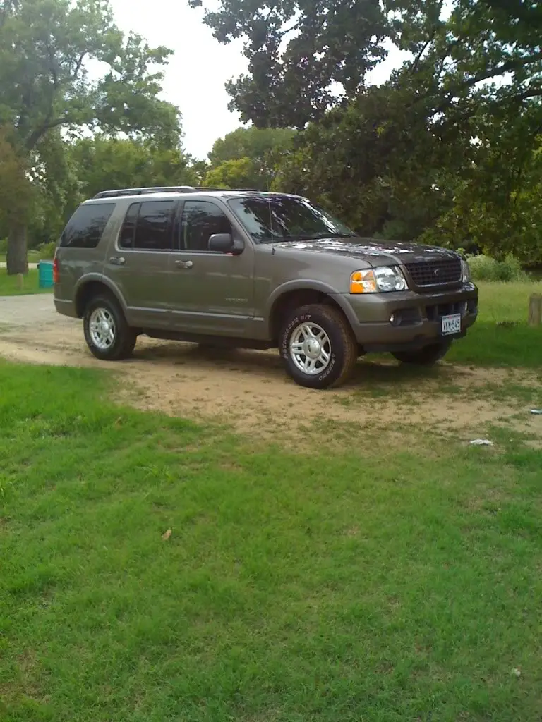

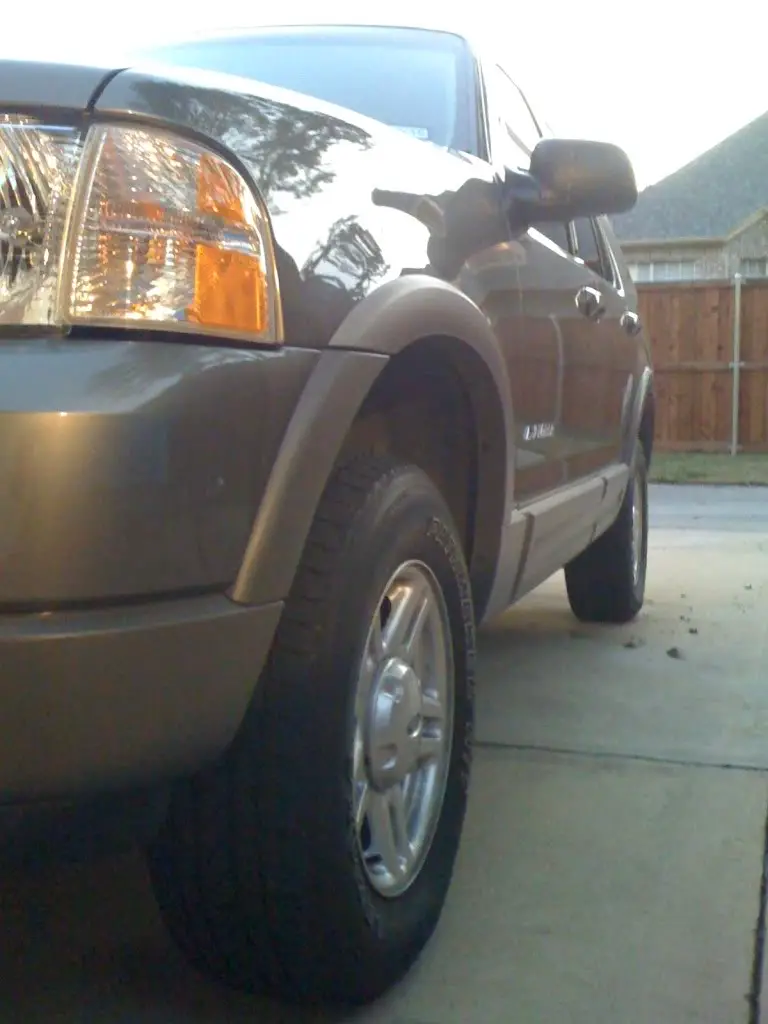

This is my old explorer before it got totaled, it had the quicklifts on the front. It did not ride as good as stock on any setting.
Wouldn't a spacer lift ride rougher anyways? Correct me if I'm wrong but any lift will ultimately ride rougher.......Overall would you do them again as lift or never again... I am considering buying them and I couldn't find someone on here to talk to me about how they liked it or didn't
Personally since my explorers are my DD's, no i would not. If i had them set to a setting for more lift, it felt like one of the wheels would pop off the ground when i went around a turn, and when it was set to a softer setting, it felt like the amount of body roll had multiplied. With a spacer lift, you would keep the stock strut, and the same amount of pressure on the spring aslong as you dont go to high, so i think the handling would be better. There is always going to be a higher center of gravity though, so i dunno...
Would i buy them again? no.
Edit: if i had them all around, it might of been a different story, because they would of all felt the same, but i dont know.
