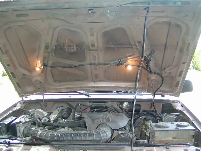

Yup I have done it on my 88 BII. I am running a KKM on the 95 Ranger intake tube. the filter sits right behind my pass headlight, above the stock BII battery tray. I however mounted my Optima on its side right where the old airbox used to be. I had to make a custom battery tray and bracket to do this, but it works great!
Optima batteries can be mounted in any position, even upside down, so thathelped me in my case to lay it on it's side.
Here's a pic..you can see if you look close...
Dead Link Removed

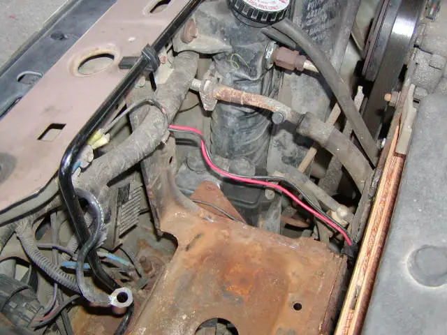

My X has been modified for dual batteries, but it is basically the same thing as relocating the battery....
In the picture here, you can see how to relocate the stock washer fluid tank, and put a battery tray in its location...the washer tank is turned 90 dergrees, and is mounted to brackets on the new battery tray. The battery would be very easy to relocate here with the stock washer tank.....
Here is a shot of the battery tray..... the wood is a spacer to keep the washer tank straight.....
