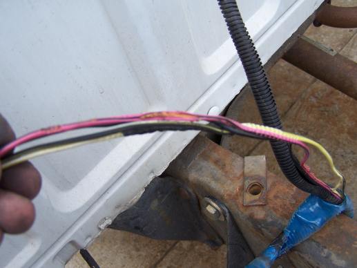

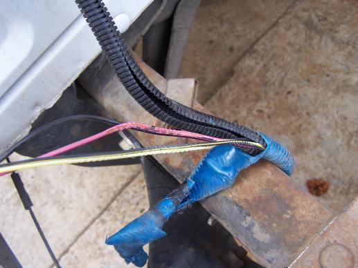

While putting my BII tank in I stripped back the plastic wire harness cover so I could cut them and extend the wires and found some of the wires were pretty trashed. From the outside all looked fine but once pulled apart the insulation was severly damaged and was bare in more then one spot. Might want to keep an eye out for it in your rangers as well.

Looks like they were crushed? Maybe from you removing/installing your bed?
Thats what I am thinking. However one of the spots was already wrapped in electrical tape so atleast part of it happened before I bought the truck.
