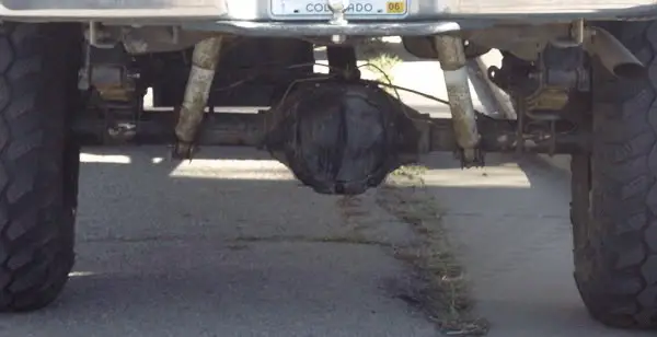

Do an SOA on the rear, keeping the stock leaf springs. They flex really well. Weld lower shock mounts (easy to fab up with angle iron) to the sway bar brackets on the diff keeping the stock rear shocks. It works out really well.
So if I do what you recommended with the SOA in the rear and get the Skyjacker 6" front lift will it also be about 6" in the rear? I don't want the rear to be lower or higher lol. Anyhow can I just buy the front lift kit or do I actually need to order all the parts for the Skyjacket 6" front lift indivdually? If so could anyone help me out with all the parts I would need to order for the front.
