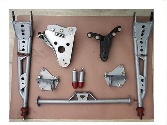

I used to run the Skyjacker class II 6" lift until I decided to do a SAS. I still have the lift kit if anyone is interested.
I'm using the coils and rear leafs but everything else is there so getting those parts are no problem because they sell coils and rear leaf packs seperately.
So the right and left dropped TTB brackets, extended radius arms w/brackets, new crossmember and dropped
pitman arm are what I have left of the kit.
The new crossmember replaces the stock one and it ties into the radius arm brackets.
If anyone is interested, send me an email and i'll give you a price.
Oh one more thing I forgot, the lift was on my 97 Ranger(last year of the TTB setup) but it will fit 93-97 Rangers and pretty sure it will work on any TTB Ex's, i'd do some research to make sure though...also, i'm using the shocks from the kit but who wants to run used shocks anyways...Dave
Here's a pic of all the parts, i painted them a metallic grey but tire rubbing rubbed off some of the paint so you might wabt to have them sandblasted and repainted.

Whats the purpose of the new cross member? I noticed that during the time that Skyjacker had the 6" lift on their website, they had a new cross member with it. I bought that lift off a guy on here and his did not have the cross member. Is it just for the radius arms?
Thanks for those who have inquired about the lift kit i posted. Looks like I have a buyer for the kit but if the deal doesn't go through, i'll post it again next month.
As far as the new crossmember is concerned, the location of the radius arm brackets mount exactly where
the stock trans crossmember is so they had to make a whole new one to tie into the brackets. Plus it gives the
brackets a lot more strength as opposed to being mounted by themselves. Now the crossmember is for the class II kits with extended radius arms, their regular lift kits do not use a new crossmember since it uses dropped brackets on the stock radius arms. In other words, the the stock radius arms with dropped brackets
are shorter in length than the class II kits so the crossmember isnt affected.

Dre, i'll dig up the receipt I got with my lift kit and see what the lift kit # is. It will be for a 93-97 Ranger so I don't know if it will be the same for an Explorer.
AS far as the price difference, Skyjacker offers regular lift kits and Class II kits(this again refers to the Ranger kits). Regular kits have only dropped brakets for the beams and radius arms. Class II kits have replacement extended radius arms w/ new trans crossmember as well as the dropped TTB brackets. Also, class II is offered as a KIT or a SYSTEM. Kits come with blocks for the rear and systems come with replacement leaf packs. I don't know what Skyjacker is offering these days beacause this information i'm giving you is from when I bought mine about 3 yrs ago but I hope it helps you out.
I should also mention The class II kit came with the front coils, dropped pitman and shocks. They also offer extended stainless steel brake lines at an extra cost.
Hope this info helps you out some.

I've got the Skyjacker Master Catalog from 2001.
4" class 2 lift kit part # is 234EXK-A with Hydro shocks
6" class 2 lift kit part # is 236EXK-A with Hydro shocks
There is a seperate part # listing for every part in the kit if you need to replace just one piece . I can scan it if someone wants to post it.

ok...here's the part # for the class II ranger kit:
236RHKSN-A
I also went with the Nitro shocks which is supposed to be their best and here's the price i paid for the whole deal : $1432.00 and that was about 3 yrs ago.
