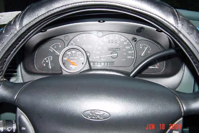

Autometer makes an A-pillar pod for the Explorer. I'm not sure of the part #, but it's on their website. Smmit and Jeg's both carry it, I believe. Here it is:

Mine normally runs anywhere from 125*-180*. Autometer also make a pod that stadles the steering column.

DocVijay - That is EXACTLY what I want. Same color and everything. Whos picture is that. I haven't been able to find a single one for the Explorer. Thanks DocVijay

I stole that picture from DocVijay. Oh wait, that's me. JK.
It's from Autometer. Like I said, I'm not sure the exact part #, but it's listed as an Explorer part. It only comes in black, but I sprayed it with Dupli-Color Medium Gray, and it matched perfectly. It attaches to the A-pillar using 4 plastic screws, and is pretty sturdy. just drill a couple of decent sized holes in the A-pillar and you're all set. Easy.
EDIT (see above post): Oh, there you go. Jeg's part # 105-15308, for $27.99. Just go to your local auto parts store and pick up the Dupli-Color and you're almost done.
