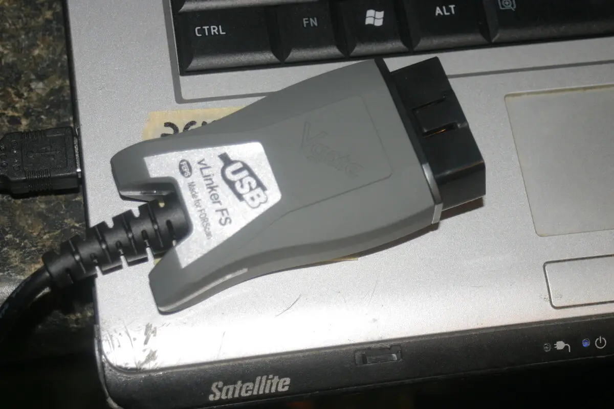

OK Retryed it.
Having no instructions I did the normal setup. Launched program.
Plug connector onto OBDII Port.
Turned key on.
Saw NO reaction to anything.
Got no reaction to any of the buttons on left side.
Pictures:
I will look for basic instructions.

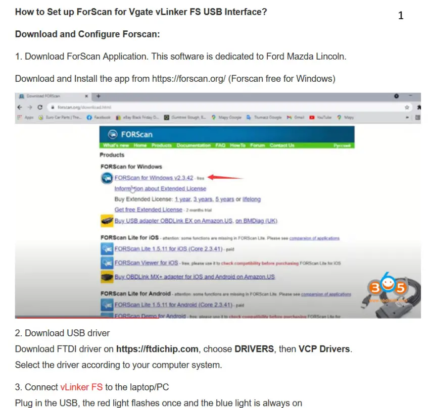

New problem, I downloaded the driver to the vlink BUT:
Followed these instructions: (see picture below)
Now it will not run/work in a Laptop running win7 as in device manger there is a yellow triangle with a “!” in it and it saids:
“Windows cannot verify the digital signature for the driver, windows require this for this device”
I've had USB based hardware be picky about which port on the PC it will decide to work. I'd remove the driver, try a different port
I tried it on two laptops and three USB ports...on XP and Win 7.
thats odd mine running 7 works just fine wonder if theres special drivers for this? does forscan still work with 7? does the dongle? sorry im just spitballing i suck at tech so not my place to say nothing. on the other hand im figuring out wix software, next is YT hahaha
