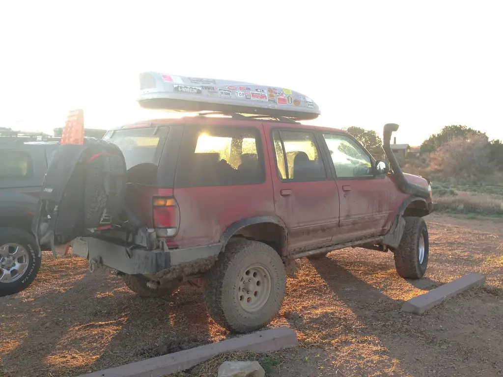

Tom and I run one on second gens

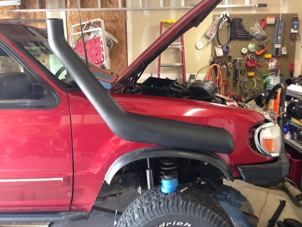

You have to decide on how you want it routed. Mine is a straight shot into the airbox, while Snakebite looks more typical.
Found one eBay for 175 arb wants like 500 for a plastic tube but there is one for a 40 series and a 60 series do you know which one? Thanks for the pics looking good
The 80 series doesn't seem to come with the flexible hose how did you connect it if I were to install it like the black explorer above?
I actually had a spare rubber intake hose I s bent it inside fender then into engine bay
