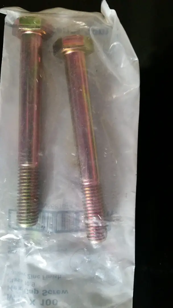

Sorry, other suspension forum seems dead, ton of views and no replies, figure try here. These are M12x1.75 100mm which is repeated on here for a TT lift. However I'm not sure if the bolt should be fully threaded, or look like this with just the tip thread? B/c it has to be rounded off also at the top to fit the torsion bars. Does this matter or are these bolts fine?
Hope someone knows asap as trying to get this done
You'll need a bolt without a shoulder, as they need to thread all the way in. The Torsion bar bolts also have a ball end , sort of a pivot point. Those will not do.

just need like another 1/2-1" inch to make it level, the driver side bolt stopped (which seems to be common reading on here), the passenger side still has room. Figure just get larger bolts. Just going to be driven on the street. Hoping this will help a bit too as my 31's are rubbing like a **** on the foot board fronts when like reversing or turning at almost full lock, especially if on a slant like coming out of my driveway, sounded like I ripped the foot board off. How the heck do others fit like 32's without trimming lol?!?!
So it has to be fully threaded, and yeah the shop I had finish the front suspension as I gave up dealing the LCA said they can round off the tips to fit the torsion bars.
