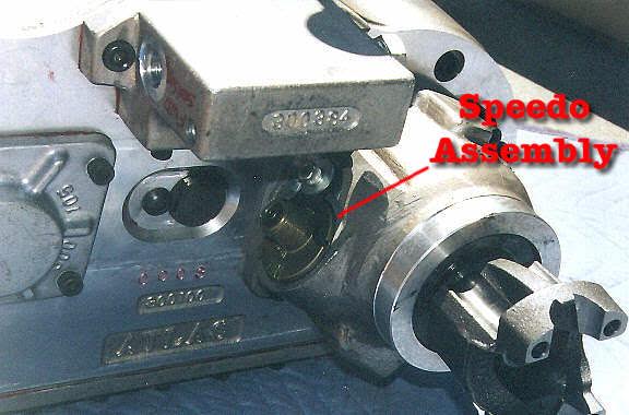

So for those that did this in the 2nd gens, I am unsure about the VSS setup. AA gives the proper gear, but that's all I know. They said they use the Dana 300 speedo assembly in them, but do not include it. So from what I can tell, they send you the case with a speedo hole in it. They say to have Nevada speedo make a signal converter, but do not say what else I need to make that work. Nevada speedo asked if they include the cable tube. I said all I know is they send the speedo gear for my ratios.
I just don't know exactly what all I have to do to get the VSS working. They sent me this pic saying this is what the case uses, but it is not included. The sales dept is not being very forthcoming to what all they send & what I need.
I'm about to be in the same boat as Jeffe was with getting this installed in time for an upcoming meet. I will have a few days to install it, and be ready to hit the road, and am attempting to get my ducks in a row. Any help with info on what I need to get, is appreciated.
